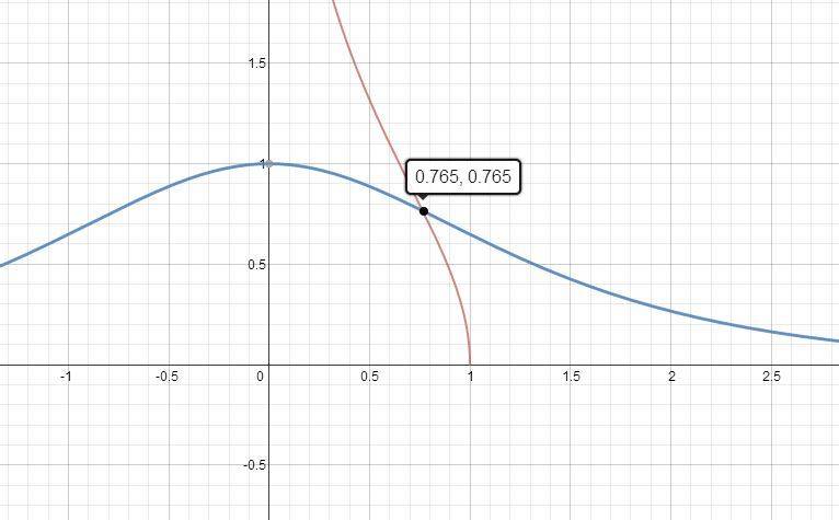

Compare the graphs of ##\ y=\text{arcsech}(x) \ ## and ## y=\text{sech}(x)\ .##
Integrate ## y=\text{sech}(x)\ ## to get an area related to that given by integrating ##\ y=\text{arcsech}(x) \ .##
You will have to subtract the area of some rectangle.
I plotted two graphs and yet I can't figure it out... :(
The definite integral you are evaluating represents the area below the y = arcsech(x) graph which is between x = 4/5 and x = 1 . Notice that arcsech(4/5) = ln(2) .
That is the same as the area below the y = sech(x) graph and above y = 4/5, for x ≥ 0. Right?
