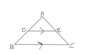

In the following diagram D and E are the midpoints of AB and AC. Use vector methods to prove that DE = 1/2BC
DE = 1/2 BC
AD = 1/2AB
AE = 1/2AC
AD + DE = AE
DE = -AE + AD
DE = -1/2AC + 1/2AD
IF BC = -AC + AB
AND DE = -1/2AC + 1/2AB
THEN 1/2BC = DE
Diagram -
hi crayzwalz! :smile:
yes, that's correct, except …
i] your + and - are the wrong way round in
DE = -AE + AD
and
IF BC = -AC + AB
ii] you should write it all out in one sequence, with the first line
DE =
and the last line
= 1/2BC :wink:
