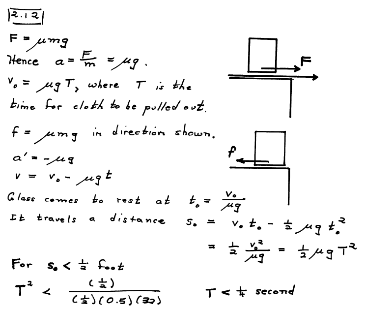

P.S. The official answer is shown below:
Handwritten solution to problem 2.12: F = μmg, so a = μg; glass decelerates at μg after the cloth is pulled out, stopping after a travel distance s0 = (1/2)μgT^2, giving T < 1/4 second.

Update: Yet if I cross out the second equation, the time it takes to yank the cloth out is independent of the force. Since there is nothing to be maximized, what's the point of asking for the "longest time"?

As @hutchphd alluded to, the dynamics of the cloth are irrelevant. We essentially have a glass that accelerates uniformly at ##\mu g## and then decelerates, in a symmetrical manner, with a magnitude of ##\mu g##. The symmetry allows you to deduce the times for each stage are equal. The speed time graph is an isosceles triangle!
It is the longest time because the cloth can be pulled out arbitrarily quickly so that negligible impulse is initially imparted to the glass, causing it to come to rest well before the end of the table.
Can the answer T = 1/4 s be correct? If the cloth accelerates the glass for 1/4 s, where will the glass be located on the table at the instant the cloth is completely out from under the glass?

Not quite. I think the assumption is that without the cloth the friction is big so it decelerates "instantaneously"...makes the problem easier.too

I will bite the bullet... doesn't the question say the coefficient of friction without the cloth (i.e. glass on table) is 0.5?
etotheipi said:
It is the longest time because the cloth can be pulled out arbitrarily quickly so that negligible impulse is imparted to the glass, causing it to come to rest well before the end of the table.
Oh this makes sense. So we only pull the tablecloth during the first half of the journey. After the external force is removed, the friction changes its direction. Thanks James!

They let ##s_0## represent the distance traveled during just the deceleration phase. But they took this distance to be 6".

Oops. You are indeed correct. Doesn't that make the published answer incorrect by 2?)

Yeah, they should have ##s = \mu g T^2 = 6\text{in}##

Reading the official solution, it looks like they left out the distance covered while being accelerated by the cloth.
It makes the the answer too much by a factor √2.
