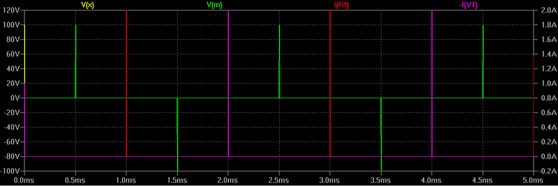

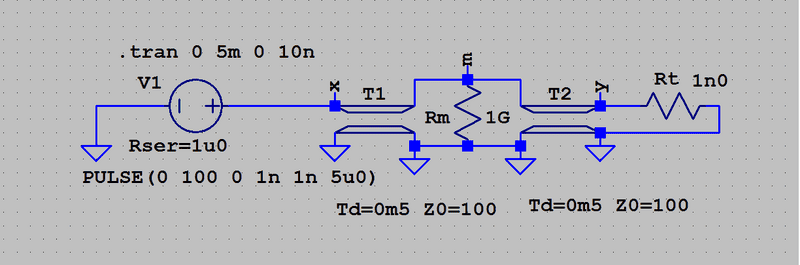

Here is my simulation in LTspice.
The 1 ms long line, is broken in two so you can see the voltage at the mid-point.
This is the voltage and current plot.
The (yellow) 100 V input pulse, initially generates a (magenta) 1 A pulse into the 100 ohm line.
The current that flows in the source during the reflections that follow is (magenta) 2 A, since it is the sum of forward and reflected currents in the short circuit.
The (green) voltage at the line midpoint, is inverted by the reflection from Rt. It remains 100 V since it is 1 A flowing in a 100 ohm line. You can tell which direction the pulse is travelling by its polarity, and the time.
The (red) current in the Rt is also doubled by the reflection process.
Dummy resistors are used to represent open or short circuits, while satisfying the requirement that nodes are part of a network, so voltages and currents can be sensed. The voltage generator current is inverted in the plot, since the current polarity of sources in LTspice, is defined as the opposite to loads.

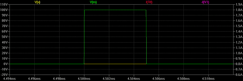

Here is the voltage pulse at the midpoint of the line, time magnified, after bouncing around for 4.5 ms.

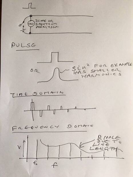

I came across this sort of question when pulse testing transmission lines for television transmission. Consider the case of a transmission line having some loss but no dispersion. It is easier to take the case for sending at one end of the line which we will assume to be open. Assume the far end is open circuited. In the time domain, we will simply see the pulse echoes arriving at intervals equal to twice the line length and gradually diminishing. In the frequency domain, taking a single pulse, we see the fundamental frequency of the pulse, which is given by 1/2T, where T is the duration. We will see every harmonic of this fundamental frequency, and their amplitudes will gradually diminish, depending on the shape of the pulse, be it rectangular or smoothly shaped, such as sine^2. We now consider a frequency Fo at which the line is half of the corresponding wavelength. So Fo = 2c/L. At this frequency the sending end of the line will have maximum voltage because it looks like a high resistance. At all higher frequencies where the line is a multiple of half a wavelength we also see a maximum. So the frequency domain spectrum consists of the fundamental of the pulse and the diminishing harmonics, and the envelope is modulated by the slow ripple caused by the line length. For example, if the line is 150m long, we see a gentle peak every 1 MHz. It is possible by looking at such a frequency domain response, to find the distance to the end of a line, or to an unwanted reflection. If the line is short circuited instead of open circuited the ripple has the same frequency except at the beginning.
