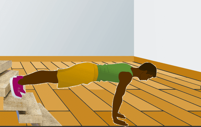

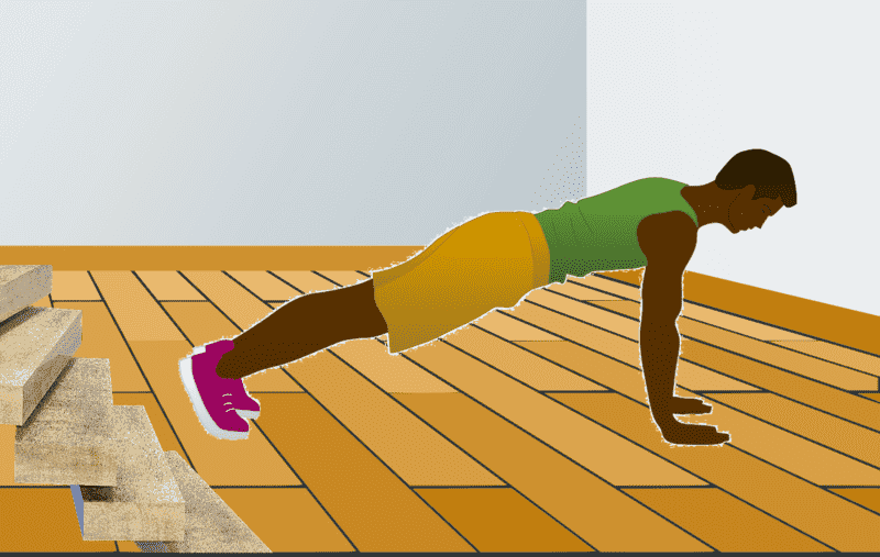

If I do push-ups off the floor as you'd normally do, they're hard enough. But if I elevate my feet on stairs, so my body is horizontal at the start, they feel harder. Are they?
I've been slowly increasing my push-up count, using the traditional pose:
For a lark, I thought I would try it with my feet on the stairs, so my body is horizontal at the 'up' position with my arms fully extended. It turns out, this seems to require a lot more effort:
But am I actually doing more work, or is it just that the unfamiliar posture makes it seem that way?
I've been trying to figure out if the 'feet on stairs' position puts more weight on my arms, but I can't see that it would because the same four points of my body are supporting my weight. Or, it might be that my centre of gravity is shifted with the feet on stairs, and that causes me to be lifting more weight...but that doesn't seem right, either.
Any thoughts on whether it's all in my head? Or are my arms really trying to tell me something?

More of your body weight is on your arms in the second position. It must be about 50-50. In the first position there is more weight on your feet.
Do a free body diagram!

The angle of the body changes, but the location of your center of mass does not shift.
Think of both extreme positions: standing up straight on your feet only (100% feet/0% hands), and on your hands only (0% feet/ 100% hands).
Please, see:
https://www.physicsforums.com/threads/the-physics-of-the-inclined-pushup.953338/
https://courses.lumenlearning.com/suny-physics/chapter/9-6-forces-and-torques-in-muscles-and-joints/

Thanks, @PeroK, I've had to look that up, but I can now see why there is a difference...and why my naive thought that "my weight is my weight" wasn't quite right!
Melbourne Guy said:
OMG, @Lnewqban, great link, I'm slapping my forehead that I didn't look first! Thank you for doing my research for me :oops:
