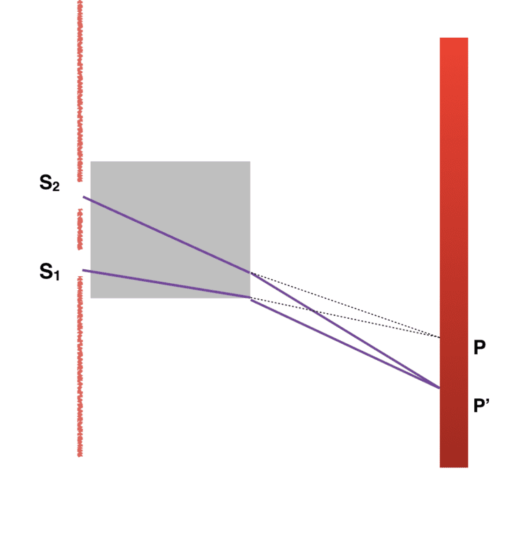

Find the equations of path difference and the equations for maxima and minima.
#path~difference ~= d\sin\theta#.
If I put a slab of some material whose refractive index is [itex]\mu[/itex] and width is [itex]D[/itex], in front of slits in Young's Double Slit model, then
In the figure you can see that I have placed the slab just after the slits. So, when rays going to come out of the slab they will bend away from normal (here I'm assuming that the material of the slab is optically denser than the air) and due to this bend they will intersect at P' and if the slab were to be absent they would have met at P. So, a pattern at P has shifted to P' but what is the itexematics of it? How to derive equations for path difference in this situation? Do we draw a perpendicular from [itex]S_1[/itex] to [itex]S_2P[/itex] like usual, but [itex]S_2P[/itex] is not a single line it gets bent just after the slab. How should I begin?

You have to determine the optical path difference between the rays separately in the slab and in air, and then add up the differences.
The optical path-length is the physical length multiplied by the refractive index.
You can consider the interfering waves parallel, as the screen is far away, and the distance between the slits is very small. No need to calculate with two angles of incidence. The parallel waves become a single wave.

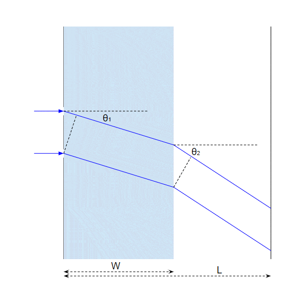

Assume an angle of incidence, determine the geometric path difference in the slab, if there is any, multiply it by the refractive index. Add the path difference arising in the vacuum, outside the slab.

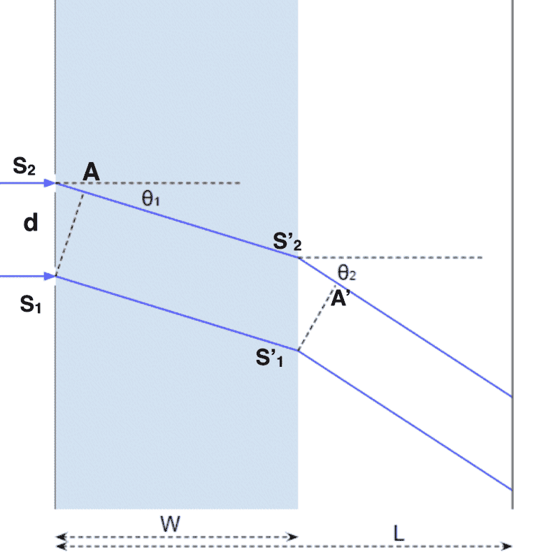

In this diagram I have drawn the rays parallel because it would make geometry easier to see.
I have drawn perpendiculars ##S_1A## and ##S'_1A'## on the rays ##S_2A## and ##S'_2A'##. By simple geometry angle ##S_2 S_1A = \theta_1## and ##S'_2 S'_1 A' =\theta_2## . Now, by trigonometry ## S_2 A = d \sin\theta_1## and ##S'_2 A' = d\sin\theta_2##. Therefore, $$ total~path~difference~= d\sin\theta_1 + d\sin\theta_2$$. Am I correct so far?

There is also a path difference between the rays at the exit from the slab.
Does that mean the two rays were of equal length inside the slab? So, total path difference is ##d\sin\theta_2## ?
Yes.

By Snell’s Law $$ n_1 \sin\theta_1 = n_2\sin\theta_2 \\
\sin\theta_2 = \frac{n_1}{n_2} \sin\theta_1$$
Therefore, the path difference is ## d ~\frac{n_1}{n_2} ~\sin\theta_1##. So, for constructive interference we have $$ d~\frac{n_1}{n_2} ~ \sin\theta_1 = m\lambda$$ where ##m## is any integer and ##\lambda## is wavelength of the wave in medium with refractive index ##n_1## (that is air in our case).
So, why does the thickness of the slab matters? This equation is totally independent of width of the slab. Please explain.

You got the condition for constructive interference in terms of the angles - theta1 or theta2. But you observe the light spots on a screen. At what distance x is the first spot from the central one? Assume the slab has thickness T and the screen is at distance L from the slits.
What happens if you observe the spots on the rare side of the slab (which is matted)?
Okay. So, when we solve for shifting we need to consider the thickness, I got it.
