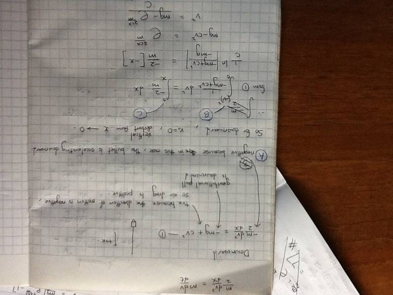

A gun is shoot straight up. Assuming that the air drag on the bullet varies quadratically with speed, and the equation of motion for the bullet is (m/2)(dv^2/dx)= -mg-(cv^2).
Find for the downward motion , v^2 in terms of x.
Taking that upward direction is positive.
From the thing I uploaded, is my A statement correct?
is my B, (-V)^2 correct?
in C , that is displacement or distant? I think that is displacement.
Please guide , thanks
Hope correct orientation

You justified the minus before ## \frac {dv^2} {dx} ## by saying that the acceleration is downward. You justified the minus before ## mg ## in the same way. Thus ## - \frac {dv^2} {dx} ## must be negative (to be compatible with the negative ## -mg ##), thus ## \frac {dv^2} {dx} ## must be positive. So the acceleration downward ends up being numerically positive, which is wrong given the sign convention.
When you integrate the equation, I do not understand why you integrate from x to 0 - it should be the other way around.

So do you mean A is correct?
from x to zero because I take upward as positive direction, then the motion of the bullet is downward, is from x to zero, isn't? Do you mean I should take zero to x?
I said "wrong", so it obviously cannot be correct.
When you integrate a differential equation, you integrate both sides from start to end. Where is the start and where is the end here?

I am sorry ,not really understand, the acceleration downward ends up positive is exactly the situation when the bullet is downward.
A bit confused ,the acceleration here should take its sign as acceleration or deceleration or up or down ?
The bullet to upward will start x= 0 , end at x.
The bullet downward starts x ,ends ai x=0 .

The sign convention is "positive" for "upward".
The entire term on the left, when evaluated numerically, must be negative because the term on right is always negative during the downward motion.
The minus sign on the left implies that ## \frac {dv^2} {dx} ## is positive during the downward motion, which means that the acceleration is numerically positive - which is wrong with the given sign convention.
x originally meant "current position". What you do makes it "starting position of the downward motion". If that is what you really mean, I suggest you use some other symbol for that.
Continuing from the last sentence in #9. What you do also means that ##v## that you find after integration is not the velocity at position x, as defined originally, but the velocity as the shell hits the ground, falling from height x. Is that what you are supposed to find?

Let's say now I drop the negative on my left , then the answer comes out on the right will be negative ,this tell us that the left term is going downward. If I want to calculate the value of acceleration ,I have to drop the negative sign ( as it only tells direction) , is that correct?
Yup.
The answer you get in this case is that the power in the exponent will be negative. Which makes perfect sense physically.
I am not sure what negative sign you mean here.
