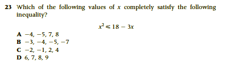

As attached
[/B]
The answer is stated as option A.
However, my solution is -6≤x≤3;
I can seems to find an option that fits the solution.

I agree. The question is wrong.
Your solution looks solid. There must be a problem with the question. Just trying values in the options show that you are correct.
7: 49 < 18-21 -- Nope.
-7: 48 < 18+21 -- Nope.
4: 16 < 18-12 -- Nope.
etc.
You can rule out all the options on the page.
Man, you've been having a string of bad luck with your textbooks containing faulty problems. If the problems are this bad, I wonder if the material is equally flaky?
Agreed, those options are wrong (and your solution is correct). There's probably a typo in either B or C.
