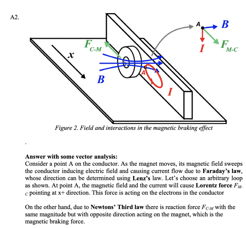

When a magnet moves near a non-magnetic conductor such as copper and aluminium, it experiences a dissipative force called magnetic braking force. I am rather confused by the following explanation of magnetic braking force:
The non-magnetic conductor here is the aluminium 'wall' seen on the slope, and the magnet is the doughnut-shaped ring seen rolling down.
Firstly, do let me know if the following explanation for why the current is circular is correct: Because the flux through a portion of the wall is increasing as the magnet moves nearer to it, the current induced produces a B-field to repel the incoming magnet, so as to reduce magnetic flux.
Given that the current is circular, and anticlockwise, I understand why there is the force ##F_{M-C}## acting on it. However, how does the reaction force come about?

This is an interesting take on the phenomenon. I gather that your explanation is that kinetic energy is converted to heat energy, thus slowing down the magnet. I understand this explanation, but may I know how the forces argument works? I am still confused about the “reaction force” due to Newton’s third law.
I am thinking that 2 currents are actually induced. In the portion of the wall which the magnet is rolling towards, the magnetic field should be opposite to the field of the magnet (repulsive), and in the portion of the wall which the magnet is rolling away from, the field induced should be attractive. Is this the reason why it slows down, because the front is being repelled and the back is being attracted?

Faraday's law says EMF's get generated, and the associated electric fields will put electrons in motion. These charges will also experience magnetic fields. The force on the moving magnet appears to be mostly of the magnetic dipole kind. Perhaps someone else can offer a simpler explanation, but other than considering it as a dipole repulsion that occurs, the complete analysis of what happens in the aluminum is rather complex.

Would I be correct to say that 2 “dipoles” are generated, 1 dipole that repels the front of the doughnut magnet, and another dipole that attracts the back of the magnet?
Something like eddy current brakes, but in this case the magnet is moving.
See Note 2 of post 2 above. You can consider the current loops in the aluminum to be magnets with a north pole and a south pole. If the north pole of the moving magnet is closer to the aluminum, and moving toward it, the north poles of the current loops in the aluminum will be facing the magnet, with the south poles farther away, and thereby repulsion occurs.
