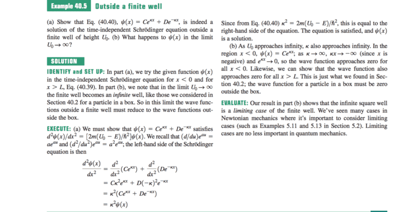

Referencing image attached.
Textbook page titled Example 40.5, Outside a finite well, with part (a) and (b) problem text, a solution section with identify, execute and evaluate steps, and a derivation of the Schrodinger equation for psi(x) = Ce^(kx) + De^(-kx).
I'm not sure how the example arrived at ψ ⇒ 0 at x<0 and >L as K ⇒ ∞ in the limiting case of an infinite potential well.
I tried simply applying limits to the wavefuction but in the case x<0, the answer I was arriving at was simply ∞ as the term with constant C approaches 0 and the term with constant D approaches ∞.
I'm also clueless as how ψ ⇒ 0 for x>L.
Can anyone help point out what I'm missing? Thanks in advance.

From the explanation at (b) you see that D = 0 for x < 0 . Idem C = 0 for x > 0.
Why this is so is indeed not mentioned. So: how can they claim that ?

I assume that this is a possible solution arising out of the Schrödinger equation for a 1D finite well, and that C and D are adjusted to ensure that this wavefunction meets boundary conditions? Is this answer somewhat correct?
The wavefunction has to be normalizable. That excludes terms ##e^{+x}## on the far right and ##e^{-x}## on the far left.
