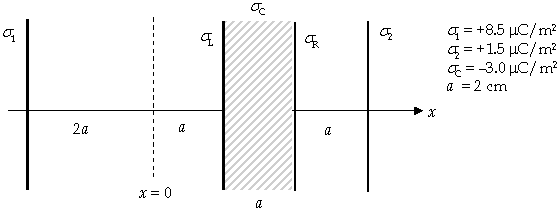

Two infinite sheets with surface charge density σ1 and σ2, respectively, are oriented perpendicular to the x-axis. An infinite, conducting slab of thickness a is placed between the charged sheets as shown in the figure. The conducting plate has a net charge per unit area of σC.
Calculate the x-component of the net electric field at x = 0.

QUESTION 15**
Calculate the surface charge density σR induced on the right hand face of the conducting plate.

14. for this number, i suppose left part of the conducting plate has the charge density -1.5. that gives the total E at x = 0 equal to 10. i use the formula E = sigma/2Eo = 10/(2*8.85) to get the answer C
15. I have no idea. I thought it was c, but the answer is B.

Apply Gauss' law to the Gaussian cylinder of cross-sectional area da enclosing the left surface of the conducting sheet (ie. ending in the middle of the conducting sheet where the field = 0) and x=0. You know that the net field through the left surface of area da is equal to the field at x=0 (ie. the answer to question 14) and the field through the right surface of area da is 0.
So applying Gauss' law: [itex]E_x\cdot da = dq/\epsilon_0 = \sigma_L da/\epsilon_0[/itex]
which means that [itex]\sigma_L = E_x\epsilon_0[/itex] (work out the polarity from the direction of the field, which is the direction in which a positive charge would move).
Then it is just a matter of working out what the charge density on the right is so that the total charge density is [itex]\sigma_c = -3.0 \mu C[/itex]
You don't need to suppose. The electric field induced by an infinite sheet is sigma/e0, regardless of the distance to the sheet. That means the conducting plate induces sigma_c/e0 everywhere except inside the plate, so you can just add up the electric fields and get the anser.
