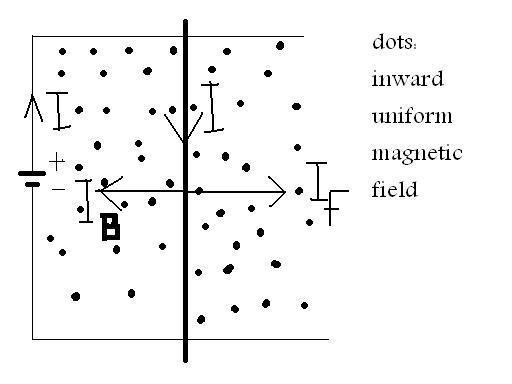

if i have a current carrying wire(connected to a battery=V) of length (L)& of intensity (I) & perpendicular to a uniform magnetic field(B) then a force act on it (F=LIB)
so when it moves...if it changes the no. of magnetic field lines inside its circuit then it induces emf also a current which is oppostie to the one already passing in the circuit so the (F) decreases gradually until the induced emf become equal to the emf of the battery
so the final situation
Wire with no current (because of equilibrium that happened) moving with constant velocity...
is that right?...or i have missed something...

but Although the field is uniform and no rotation...,the area of the circuit increases gradually so does the magnetic lines in the curcuit consequently...a current is indced.
The picture may make it more clear.

hi max11011! :wink:
max11011 said:
Thanks. ..tiny-tim for ur reply
ah, yes, if the area is increasing :smile:
(btw, shouldn't "dots" be coming up towards us? :wink:)
If there is resistance in the circuit then the back emf will equal the supply emf -Ir.
This is the simplest case to consider when there is resistance present
