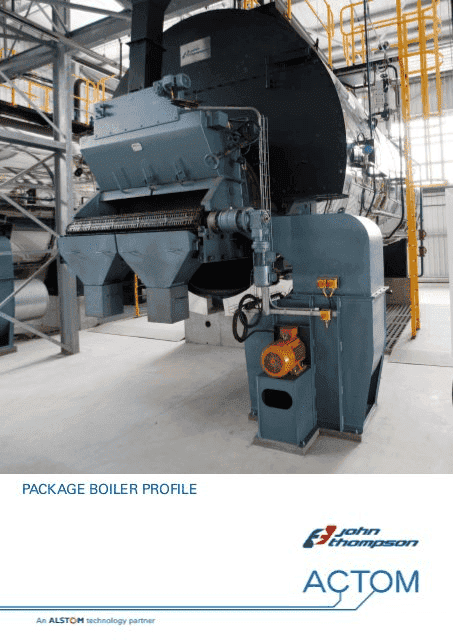

I have quite a bit of experience in the operation of boilers. I worked for a asset management company that operated and maintained boilers for factories. I don't have much experience with power generation though. This is what I know.
With a normal packaged boiler:
The factory activates more of their machines- more steam is being drawn through the steam lines from the boiler. Steam is produced from water that has entered the boiler, therefore the boiler's water level starts to drop. More feedwater must enter the boiler to make up for the steam that is leaving. The water entering the boiler must always equal the steam leaving the boiler on a tonne for tonne basis. Actually, to be honest, the amount of water entering the boiler will always be more over a given time period. The reason for this is that a certain amount of water is being dumped from the bottom of the boiler periodically to get rid of dissolved solids that get concentrated in the boiler water over time.
Bottom line: If more steam is being drawn from a boiler then more feedwater must be pumped into the boiler. If you fail to do so the water level in the boiler will drop and you will have a very unsafe situation. If you want to destroy a boiler and the surrounding countryside, let the water level inside it drop below the safe working levels. I'm pretty sure that more boilers fail due to lack of water than from overpressure.
Under no circumstances will water be allowed to circulate between the feedwater tank and the boiler directly. The feedwater tank is a storage tank that collects water for use inside the boiler. In a good system a lot of that water will be coming back from the process and some of the water will be coming from municipal supply. So a combination of municipal water and condensate enters the hotwell tank (feedwater tank). That water is then pumped from the hotwell tank by your feedwater pumps. The feedwater pumps pump directly into the boiler. Water must be pumped into the boiler at a pressure slighly higher than the boiler pressure, otherwise the water will not move into the boiler. Yes, the pressure before and after the boiler is almost the same.
Now to answer your other question regarding fuel. Yes, if you draw more steam from a boiler you will have to increase the fuel supply. With a packaged boiler the increase in steam draw will result in the pressure dropping inside the boiler. This drop in pressure is detected by a transducer which then signals the Induced draught fan to speed up so that more air gets drawn through the flue. The Forced draught fan then picks up that the induced draught fan is pulling more air and it speeds up as well. The fuel delivery system is linked directly with the forced draught fan and it speeds up as well. Thus more air and fuel gets delivered to the boiler so that more energy get's liberated into the water and steam supply can be maintained at the correct pressure.
With a power generation boiler things are similar. They have economizers and superheaters and the water is a lot purer than for packaged boilers, but the basic idea stays the same. Power station boilers are often water tube instead of fire tube as well because the pressures are much higher, but once again, the basic idea stays the same.
If I remember I'm going to add in some diagrams tonight. Hopefully that will make things more clear.
I hope this has made sense. My experience is with these boilers:

I hope this has made sense. My experience is with these boilers:View attachment 247052
