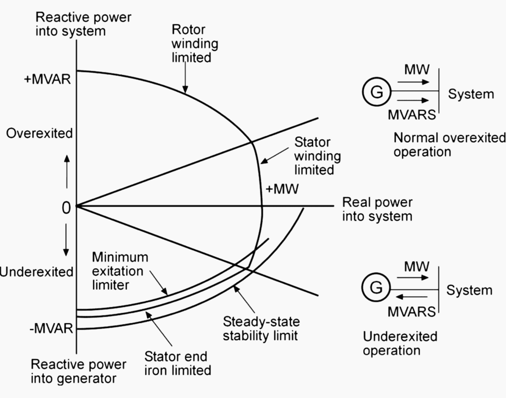

Sigh. There are a lot of issues here, and I'm afraid a few language barriers.
A generator capability curve is not something operators can set. It looks like this.
243230
But I accept that your operators do set something you call capability. It is the maximum MW for each generator? If yes, how do they decide today where to set it?
Since you said that frequency changes with load, is it correct that the plant you are talking about has no connection to the power grid?
The limits to how fast and how much in a power plant are set by constraints. How much and how fast may the voltage change? frequency change? pressure change? drum level change? fuel flow change? temperature change? and so on. The complete answer to your question, you would need to find the limits to all those critical parameters (there may be 30-50 of them), and then calculate how they vary dynamically. Most important, you need the details on all the control systems in the plant. That means a full transient simulation of the entire plant, and it probably can't be completed in 6 months.
A second approach is to ask the manufacturer of the boilers. They may have max/min and ramp limits published for that equipment that are based on their own analysis when the equipment was designed.
A third approach is to experiment. Go to the power plant and stage some tests with step changes in the MW set point. Record all the critical parameters. Then compare those changes with the operating limits. You may then be able to extrapolate to estimate the maximum rate of change allowed. An experimental approach might well fit a six month project.
But you will not find formulas on the Internet. Nor will you get more useful answers from engineers without first supplying all of the drawings and technical information about all the equipment in the whole plant.
So, my advice it to not start with technical questions. Start with your professor and adviser, to discuss the proper approach and the proper goals for your project.
When engineers design equipment, they start with requirements. What must this equipment do to be successful? The same can be applied to a research project. Requirements and goals first. Define what "successful project" means.
Good luck.

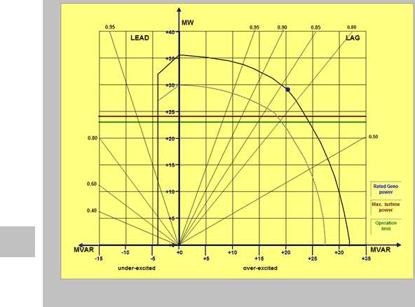

Hi Mr.Anorlunda,
my question was not about the trip of Furnace or Boiler, but if in a sudden the load is increased on the generator then the primary spinning reserve will comes into action for few seconds as per some literatures i have read. my question is does the steam header have extra steam to serve this generator in terms of spinning reserve?
243296
so the capability curve i have seen looks like this where the line in red colour is set by the operator and he does on the assumption that turbine can serve only upto that limit. but what if the steam in header is not in the level to serve turbine to reach that limit?
my ultimate goal is to measure the steam in the system(Excess steam) on which we can rely in the emergency situation like sudden increase in load.
thank you again for ur time and response!

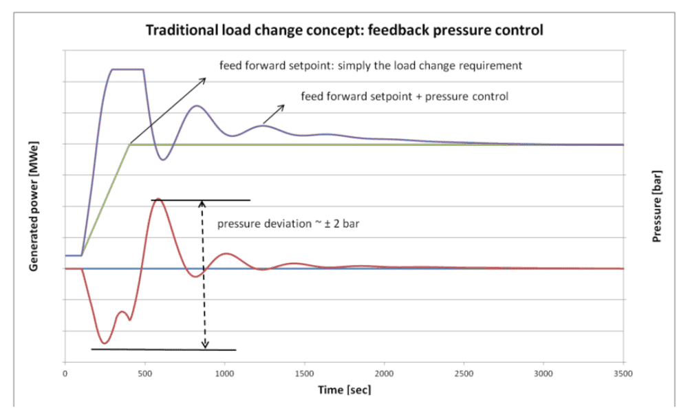

We are getting closer. A sudden change in load is normal, it happens all the time. Only the size of the change determines if it is normal or emergency.
When you get a sudden increase in load, the frequency drops, the turbine speed governor opens the throttle valve to let in more steam. That causes the steam pressure in the headers to drop, and yes there are a few seconds of energy storage in the header. The drop in pressure causes more boiling in the drum to produce steam. There is much more energy in the form of hot water in the drum than steam in the headers; enough for 1-2 minutes. The boiler control system will increase the fuel flow, and will adjust the feedwater flow. Everything is interdependent.
So how far can you push that whole thing; how much load change? Like I said, it is not just frequency. It is all the pressure, temperature, and water level limits that might be the most limiting.
None of that relates to the maximum MW limit shown by that red line. Why do you think it does?
This paper may help you understand. http://www.amecfw.es/documents/down...s/challenge-fast-load-change-requirements.pdf Here is one of the figures from the paper.
