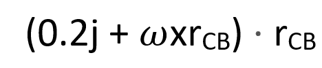

a⋅(b x a) = 0
Is my working below correct? In particular, can you apply the rCB to both the first part of the bracket (0.2j) and the second part (w x rCB) individually like that?
My second question relates to:
Is that correct? Does it matter if rCB is multiplied at the end or start? I am inclined to think it doesn't as it's a dot product?
Both are correct. The first because the dot product is (bi-)linear, the second, because it is symmetric.
For the third term to equal zero, you can use the identity ##(\vec{a}\times \vec{b}) \cdot \vec{c} = (\vec{b}\times \vec{c}) \cdot \vec{a} = (\vec{c}\times \vec{a}) \cdot \vec{b}## and the anti-symmetry of the cross product: ##\vec{a}\times \vec{a} = \vec{0}##.
