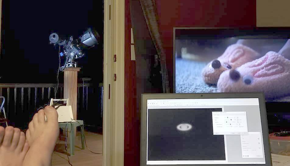

I do like to think of myself as pretty hardcore still...
It can be a rough 15 minutes setting up if it is cold outside at least.
Note: in this room/furniture configuration I'm close enough for just the one USB extension cable, which you can see hanging off the side of the white box under the scope (the shiny black thing is some sort of active female socket). I said above you're limited to 10m and 2 cables, but that may not be strictly true: the white box houses a standard USB hub with a 1m cable - the grey cable sticking out the back. So when I use two 5m cables I'm really at a total of 11m and I've never had an issue. I can't remember though if I've done that since I switched to USB 3.0.
