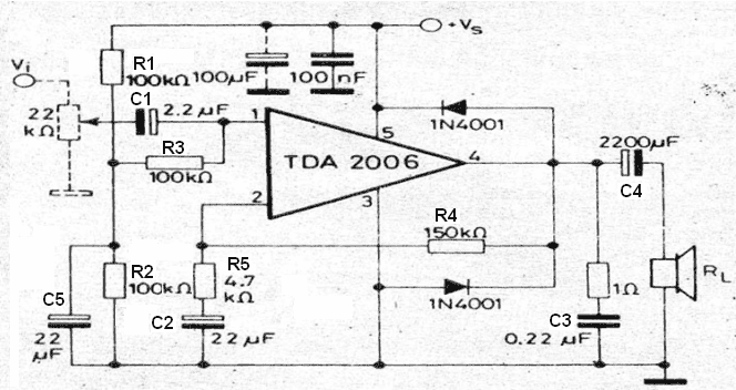

Question based on folllowing diagram (TDA audio amp):
The discussion focuses on the design and functionality of a TDA audio amplifier circuit, specifically addressing the critical frequency calculations for low-pass and high-pass filters formed by capacitors and resistors. The 2.2 µF capacitor and 100k resistor create a high-pass filter to eliminate DC input, with a cutoff frequency of 0.7 Hz. The addition of a 22 µF capacitor in parallel with the 100k resistor serves to bypass the amplifier and enhance gain, while the 0.22 µF capacitor and 1-ohm resistor form a Zobel network to prevent high-frequency oscillations. The maximum output power is calculated based on the supply voltage and speaker impedance, with considerations for voltage drop across the TDA. Coupling capacitors filter DC from the amplifier, and diodes protect against inductive kick.
katuan
guys for the critical frequency for low pass is it the following: 1/2pi* 2.2*10^(-6)*100k?
The 2.2 \mu F capacitor and the 100k resistor connected to 1 form a high pass RC filter. This is meant to remove all of the DC that may be present on the input of an audio amplifier. The cutoff frequency is \frac{1}{2 \pi R C} which comes to 0.7 Hz. The output capacitor and the speaker will form a high pass filter with a much higher cutoff.
ok got it, but how about the 22Mircofarad capacitor connected in parallel to the 100K is that for bypassing the amplifier to increase the gain? And one more thing why is there both a 22 microfarad connected to the 4.7 k and there's a 0.22 microfarad connected to the 1 ohm i can never figure that out
Because the TDA is supply from a single power supply. We need to bias the TDA somewhere in the middle of his "linear region". And this is a job for input voltage divider (R1,R2 = biasing resistors). C5 (bypass capacitor) was added to short any signal present at voltage divider output to ground.
For example, without C5 any noise from +Vs will appear at the "1" input. And this noise will also be amplified by the amplifier gain (1 + R4/R5).
So we add C5 to short any AC voltage present at this node.
We added C2 because we don't want to amplifier any DC voltage present at the input of the amplifier (for example TDA dc-offset voltage).
Without C2 DC voltage is also amplifier (1+ R4/R5) times. So by adding C2 we "reduce" DC voltage gain to one.
Also C2 together with R5 form a "high" pass filter Fc = 0.16/R*C = 1.55Hz.
1 ohm resistor together with 220nF (0.22uF) capacitor form so-called Zobel network or Boucherot cell. And its job is to prevent the amplifier from oscillation at high frequency that may occur due to reactance load. Thanks to this the amp will see pure resistance load (1 Ohm) at hight frequency (F = 0.16/ (1ohm * 220nF) = 727kHz )
cool got it thanks and one more thing is the maximum power given by the circuit Vs^(2)/RL?
katuan said:
one more thing is the maximum power given by the circuit Vs/R1?
No, why R1?
The theoretical maximum output power for a single power supply is equal to
Pmax = \frac{(\frac{Vs}{2})^2}{2*RL} = \frac{Vs^2}{8*RL}
where RL - is a speaker impedance.
But this calculations do not include voltage drop across TDA (headroom voltage/saturation voltage).
But if Rl was supposed to be let's say 4 ohms then the Pmax would be 4.5 watts though according to the spec sheet the Power output would be 12 watts given that the Vs is 12volts
ok thanks Jony you're awesome and by the way just to make sure the coupling capacitors are for filtering the DC from entering the amplifier right? 100 microfarad and the 100 nanofarad
and the diodes are just biasing diodes correct?
No, these two diodes protect the output stage from inductive kick.
jony what do you mean by an inductive kick?
