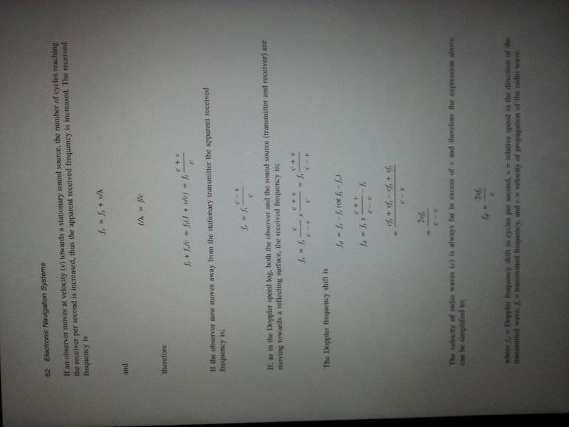

In the picture below, can you help me understand what do equations 3 and 5 mean. They concern the soppler effect but i can't seem to understand what do they represent.
ft + fv/c=ft((c+v)/c
fd=ft-fr

I find it impossible to read the subscripts in the posted image. Too blurred. Please try again, maybe just extracting the relevant part instead of the whole page.

I don't think i could post it without creatinf confusion. Could you perhaps open this link and on the page 18 you see this page.
http://sbs-on-web.com/downloads/TSS/Speed_logs_description.pdf
That helps.
The first equation in section 62 has a typo. The fr on the right should be ft.
The third equation is even worse. The fv/c should read ftv/c.
Not sure what your difficulty is with the fifth equation. The 'x' in the middle is supposed to be multiplication. The set-up for this equation is somewhat special: it describes it as the receiver receiving the waves only after reflection off a surface, and both transmitter and receiver happening to be traveling at the same speed v towards that surface. Is that interesting?
More useful would be a general equation with source and receiver each moving, at different speeds, relative to the medium.
One thing to note in all this is that speeds relative to medium is important. As a result, the source moving towards a stationary receiver (relative to the medium) at speed v gives a different effect from the receiver moving towards a medium-stationary source at speed v. In an extreme case, if the source moves towards the receiver at the speed of sound then the frequency becomes infinite, whereas if the receiver moves towards the source at that speed the frquency merely doubles.
I didnt understand what does the third equation describe its frequency minus 1/distance and the fifth multiplaying the frequancy with thw expression c-a/v what does that mean? Has something to do woth reflecting surfaces i suppose. Its full of typos

Are we on page 62? I don't see anything about frequency minus 1/distance, or c-a/v. Please type out the whole equations that you are referring to.
Yes still on 62, it says 1/u=f/v
Where u is wavelength and the next equation says ft + f/c does that make it so?

No, it doesn't say 1/lambda = f/v, it says 1/lambda=f/c.
For the next equation, as I explained in post #4, that fv/c is wrong. It should say ftv/c.

In relative motions of bodies and light, there is no medium to worry about. Here there is.
If a plane flies towards you at the speed of sound, the wavefronts stack up on the front of the plane. When it reaches you, you hear them all at once, an infinite frequency.
If you move towards a sound source at the speed of sound, your rate of encountring wavefronts doubles, doubling the frequency.
