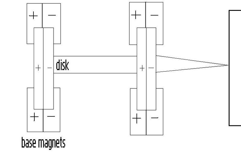

Yes, I won't have much trouble building the setup, but my concern is ordering too strong or too weak of magnets. Or overlooking something else, resulting in an unstable cylinder.
The cylinder will be supported on one side, either by a sheet of plexiglass or a large mirror. I am thinking about linking the two disks together with pvc pipe, running through the centers. The pipe will extend off to one end and eventually taper. This is the side that will be touching the glass/mirror. the same way the pencil tip does in the video.
If I understand this setup correctly.. all of the magnets polarity is split vertically, in the same direction. So i would imagine that the field would look almost like an 8 from the side. If I use enough ferrofluid, could it potentially form the shape of an 8 between the cylinder and base? I wouldn't be surprised if i am mistaken about how the field would look.. I can't seem to find any pictures showing an example of two magnets with both - and + poles facing each other at the same time. As this setup would be.
The attached image would be a top view, looking down at the setup.
I would recommend inverting one of the pairs of magnet rings, otherwise it could just 'slide' forward and so the rear - (of the ring) will contact the forward + (of the support magnet).
So your magnet rings will be -------( - , + )-------------( + , - )-------|
And the mag supports will be -------| - , + |-------------| + , - |-------|
This is of course assuming it is split down the middle as per your drawing. The split could be outside of ring North, inside of ring South (like this drawing: https://www.physicsforums.com/showthread.php?t=341215).
Aside from that there's no more to do. Strength wise, you need to check the weight of the rig compared to the repulsive force available.
No, it wouldn't make any 'figure of eight'.
