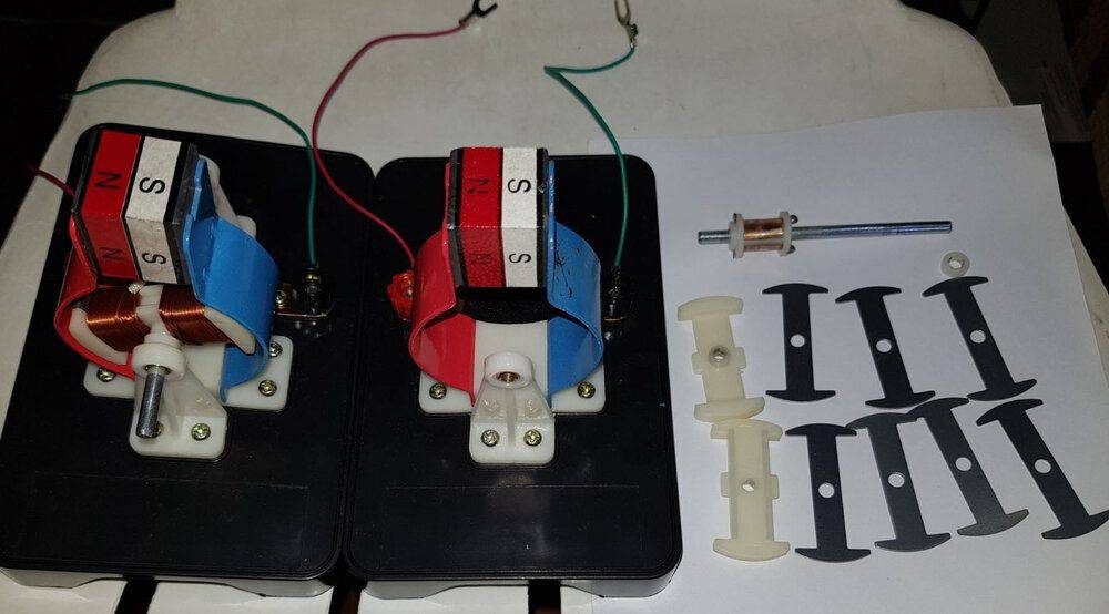

To add. Here is some weird results.
I tried to add all my 8 rechargeable batteries (1.2 x 8 = 9.8v) (all newly charged) waiting for the rotor winding to burn (so I can try winding new one for once in my life). But the motor kept running. I measured the amperage in series to the 8 batteries and it reads 1A average. But when I used the hand crank turning the same unit into generator (original design), the output reads only at most 10mA (with the 2 leds removed). And voltage is only 0.5v! I can't even get it above 1v. How do you explain this?
Is it not if the rotor is a certain given speed. It should output the same voltage or current as when you use the battery of same voltage and current to turn the rotor (at same speed)?The wiring diameter of the rotor is about 0.20mm (0.0078 inches). Again this is how it looks like. How do you know the maximum battery voltage it can take? I no longer have extra batteries to test winding burnout voltage.
Close-up photo of a homemade motor rotor: a rectangular cream-colored plastic frame wound with fine copper wire, mounted on a metal shaft with a black plastic bearing and a small screw-like end, sitting beside a black turntable-style base.

It was only when I turned the unit sideways that the rotor can rotate (see above video).
Maybe less friction??
I removed the leads less than 3 seconds as I didn't want the winding to burn up. I want to know the following:

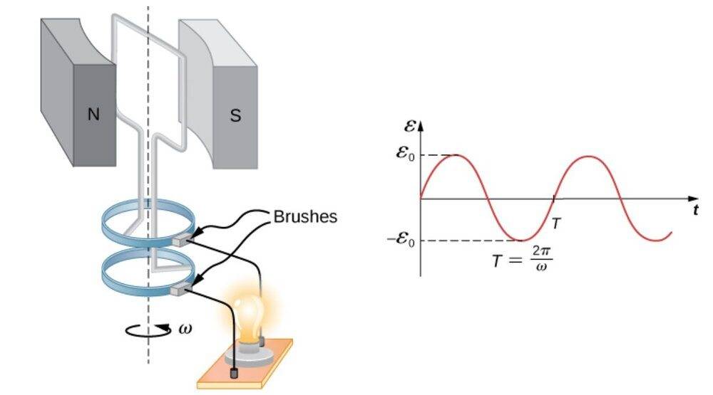

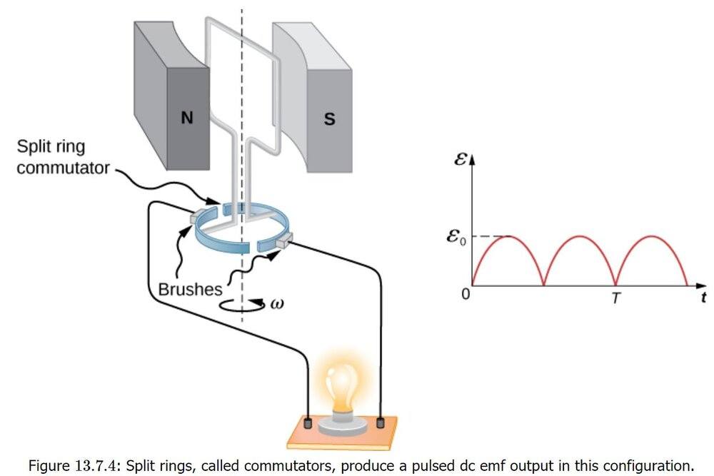

I wonder if it has to do with the split commutator. Mine is the 2nd one.
13.7: Electric Generators and Back Emf - Physics LibreTexts
Diagram of an AC generator with a rectangular loop between N and S magnets, slip rings and brushes feeding a lamp, beside a sinusoidal emf-versus-time graph marked with peak e0 and period T = 2π/ω.
Diagram of a simple AC generator with a split ring commutator, showing a rotating loop between N and S magnets, brushes touching the split ring, and a bulb in the external circuit; a graph beside it shows emf against time as a series of pulsed positive humps reaching E0, with period T.
How do you turn a pulsed dc to direct dc? Maybe this was why I was only measuring 1.2 volts at most? (when in motor mode, the voltage that can get the rotate to start rotating must be at least 7 volts?)
Could the reason be the so called back emf? that is.. in motor, you need larger voltage to make it run and not proportional to the voltage in the output when it is in generator mode? I read in article above:
The generator output of a motor is the difference between the supply
voltage and the back emf. The back emf is zero when the motor is first turned on, meaning that the coil receives the full driving voltage and the motor draws maximum current when it is on but not turning. As the motor turns faster, the
back emf grows, always opposing the driving emf, and reduces both the
voltage across the coil and the amount of current it draws. This effect is noticeable in many common situations. When a vacuum cleaner, refrigerator
, or washing machine is first turned on, lights in the same circuit dim briefly due to the IR drop produced in feeder lines by the large current drawn by the motor. "

Diagram of a split-ring commutator generator: a rectangular coil between N and S magnets rotates about a dashed axis, with brushes feeding a lamp; graph of emf against time shows pulsed dc peaks reaching E0 with period T.
What is the shape of the current for the above? Is it sinusoidal, like the above, or just plain flat line dc?
It should be something like your graph, a full wave rectified sinewave. I'd reckon a bit peakier, with the sine shape being distorted by non-uniform field and the nodes being distorted by a dead spot as the brushes are either in a gap or are shorting both sectors.
" It's the only hand crank available for about 7 billion humans. "
I'm sure I could build one myself. Maybe a bit more refined than the bits of wire I put together for your first experiment - though that did work. I think Meccano might be suitable.
I'm not quite sure what I'd be trying to find out though? These sort of motors are pretty well understood, so you can work out what should happen a lot easier than you can measure it. And lazy people like me can get all the info we want off the internet.
If you really want to measure things, this is not an easy project. A simple bit of equipment like this demo device is probably intended to show qualitative effects. Friction, resistance and efficiency are not the key factors in its design.

Two small motor kits on black bases, each with a horseshoe magnet with N and S poles, copper coil and wire leads, beside a loose coil, shaft and plastic and metal parts on white paper.
Before I put these in box and stored in the attic. I need to make a little project. I want to make the solenoid so thin it will be purely pole attraction. Remember earlier we were not sure whether it is:
"Force Exerted on a Current-Carrying Conductor in a Magnetic Field" or
"Force Exerted by Like or Opposing Poles of Magnets"
maxwell_demons gave us the distinctions. Although the amazon generator is of the former mechanism.
Do you know commercially available solenoids so thin I can just add it above instead of building one?

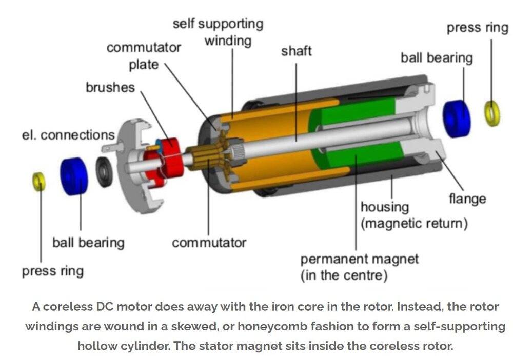

But what perplexed me so much was when I came across the so called Permanent Magnet DC motor. I watched most youtube videos about it and read many articles. But there is none that explains it clearly as the ordinary iron core dc motors.
What are coreless DC motors? (motioncontroltips.com)
Exploded cutaway diagram of a coreless DC motor showing the self-supporting winding, commutator plate, brushes, shaft, permanent magnet, housing, flange, ball bearings and press rings.
Do you know a site that explains it. After 3 hours of googling and reading dozens of articles and videos. There is none that explains it clearly and I can't seem to fathom it. How does it work compared to the typical iron core motors?

This is an interesting sort of motor. I only came across it quite recently, when looking for a low inertia motor.
It is very definitely a "wire in magnetic field" because there is no rotating iron/magnet.
The field is generated by the fixed core magnet, which is inside the rotor, but doesn't rotate with it. (You could have the magnet outside, but then it would be bigger and Neodymium is expensive.)
The rotor is made up of lots of coils, as you can see from the multi-sector commutator. The exact way of winding these, I'm still looking for, but it looks as if each coil is twisted and overlaps the adjacent coils. This presumably helps make the construction rigid, but I think also smooths the torque.
Because there is just the coils with no iron, the mass and moment of inertia of the rotor is much lower than in a traditional motor. So the motor accelerates and decelerates much quicker.
They also mention here (something I'd not thought of) that it is more efficient, because you are not continually reversing the field inside iron (or other ferromagnet.) The magnet and iron/ferrite shell are all static and have a more or less static field.
In an iron cored rotor the polarity of the magnetisation is reversed every half cycle by the commutation. When you do this, there is hysteresis and energy is lost on each cycle. You can read up on this, if you don't know about it.
Cross-section of an ironless rotor motor: red N and blue S magnet core in a grey iron shell, with a gap for the rotor coil.
The magnet and shell are joined at the far end. The coil pushes into the gap from the near end. (sorry I've missed out the axle hole in the centre of the magnet.) The coil is like a cylinder open at the far end, with the commutator at the near end. The coil is encapsulated in resin for rigidity.
The windings run on a helical path for half a turn along the sides of the coil, then double back for the second half. The next turn is slightly offset (by the width of the wire). The diagram says it is a Felix Faulhaber design, so you can look it up, if you've a better brain for 3D contortions than mine. I gather it gives a more even torque than (relatively) simple paraxial coils.

I finally did my second amazon motor modification to test pole attraction by making the rotor winding thinner than the original.
Two homemade electric motor test rigs on a black base, each with a horseshoe magnet with S and N poles above a copper-wound rotor; the right rig's core is labelled STEEL SCREW and NAIL.
I used nail and steel screw as core (because I couldn't find 2 nails). Need these to wrap the AWG #28 windings (4 times) around the shalf center. This is video of it running.
I initially used 2 AA batteries, it didn't run unlike the original amazon rotor. I then tried to use 4 batteries, It still won't run. I need 6 batteries to make it run.
Does the above prove the principle of "Force Exerted by Like or Opposing Poles of Magnets". Or do you still think there is possibility of "Force Exerted on a Current-Carrying Conductor in a Magnetic Field"?
Say, when doing winding, what happens if say one side of rotor has more winding (say double)? because I couldn't make them totally equal in length. It's tiring to rewind so I'd not make any more project, hence just need to know what would theoretically happens, like how it would behave if the north is more powerful than the south (is this possible)?.
Thanks guys!
