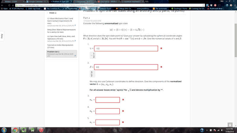

Screenshot of an online homework problem showing part a: the unnormalized spin state written as (1+i)|+> - (1+i√3)|->, with answer boxes for gamma = -1/2 and beta = 3/2 and boxes for the normalized vector components n_x, n_y, n_z.
The problem is given above. I am struggling on the first two parts, where I am tasked with finding gamma and beta.

There are multiple mistakes in your calculation. I would suggest that you start over again from the first step by first normalizing the given ##|\psi\rangle##.
I ended up getting the solution. I was making a mistake by splitting it up into |n;+> and |n;->. Instead, I factored out a phase and then normalized the whole thing. The answer came fairly quickly from there. Thanks.
