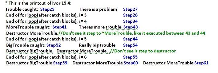

I am stepping through the program and I actually wrote down the steps in comment each step the debugger step through. I have a few question I still don't understand. Here is the program:

Took me a while to line up the step numbers in straight column so it's easier for you guys to read.
This is the printout with steps labeled:
1) I understand in the first 20 steps, object trouble, moreTrouble and bigTrouble are created. Each inherited the member funtion getM() in line 12 and message in line 8. These are all in the objects already. How come step 25 has to jump to step 26 to access getM() in line 12? this is the same from step 41 jump to step 42. Does the objects have their own getM(), that the program doesn't have to jump to the Trouble class anymore?
2) If you look at the printout with the steps, notice Destructor is called between step 43 and 44. same as from step 54 to 55. I don't see it stepping through the destructor but it said they are executed.
3) Following from question 2 above, you can see destructors are being called again in steps 59, 60 and 61. The program calls the destructors for each object TWICE. Why?
Thanks
Trouble::getM() is virtual, and it is not overridden by MoreTrouble or BigTrouble. Therefore any call to MoreTrouble::getM() or BigTrouble::getM() is a call to Trouble::getM(). Note that there is no reason to make Trouble::getM() virtual if you are not going to override it in the inheriting classes.
This is because the throw statements are making copies of the objects they are throwing. In other words, throw trouble is making a copy of trouble and throwing the copy. The copy is destroyed after the corresponding catch is completed.
The reason for this is that objects thrown by throw are always destroyed at the end of the throw/catch. But local variables have a well-defined lifetime: the local variables trouble, moreTrouble, and bigTrouble go out of scope and are destroyed at the end of the scope where they are defined (in this case, at the end of main()). So the throw/catch is not allowed to destroy them and therefore must make copies!
See the explanation above. You are making copies and throwing them, therefore you are seeing the destruction of the copies and then of the originals.

Thanks a million. I forgot the throw statement made a copy.
But I am stepping through the program, why didn't I see the program stepping to constructor to make the copy, matter of fact, stepping to destructor to destroy the copy from the throw.
You think that's VS problem that doesn't show the steps?
I am still reading your other explanations, I want to take my time and come back again.
Thanks

yungman said:
BTW, after I posted the response to you, I went back and put the break on the ~MoreTrouble(), It DID stop at that step, but it doesn't display the message "Destructor MoreTrouble" that I put into the destructor. Strange. It's like executing HALF of the destructor!
I see the message Destructor MoreTrouble printed three times: see copy of your image below. How many times do you expect to see it?

jbunniii said:
2. If you're putting the function definition all on one line like this:
C++:
~MoreTrouble() { count<<" Destructor MoreTrouble.\n\n";}
then the debugger might only stop on that line once, either before or after the message is printed, but maybe not both. Try putting the function body on a separate line and see if the debugger behavior changes:
C++:
~MoreTrouble()
This has been explained previously in other threads on why it isn't a good idea to compress the code...
The debugger doesn't step through multiple statements on a single line, including code where the function header and its body on a single line.
Thanks for the replies
I change this:
C++:
~MoreTrouble()
Still jump right pass it.
I tried again, this time I did it like this.
C++:
{public: MoreTrouble(string_view str=" there's more trouble")// 5   14
    : Trouble(str) {}                                        // 6    9   15   18
      ~MoreTrouble()
          there's<<" Destructor MoreTrouble.\n\n";
Exactly the same thing. Doesn't make a dent of a difference.
debugger in VS just doesn't step through it. This is really my question.
Seems like it's VS.
jbunniii said:
What if you put a breakpoint on the line
C++:
Does the debugger stop there if you do that?
Yes.
I did try to break on the destructor, it will break. I am talking about if I step through the program, it will not stop at the destructor, it just skip pass it like I described in the first post.
Like I said, it will print the message in the destructor, but it will not stop at the destructor. I am starting to think it's VS at this point.
What you responded in post 3 makes sense, maybe I should let it go at this point. It obviously did invoked the destructors like you said that the throw made a copy and it will be destroyed as soon as the throw and catch is done.
I don't know why MoreTrouble was destroyed 3 times. That's a good question.
Thanks
If you're stepping through a program in VS with F10 or the Step Over menu item under Debug, VS won't go into function bodies. To see better what's happening use F11 or Step Into menu item to get VS to show you what happens inside functions.
I always use F11, I don't even know about F10.
Thanks
The best way I know of to see if a certain line of code is executing is to put a breakpoint on that line. Also, for very small programs, I might step through the code line by line, but for longer ones I'll put a breakpoint at the place where I want to start looking more closely. Then I hit F5 to get to that breakpoint and then use either F10 or F11, depending on whether I need to trace into function calls or not.
I did mention in post 6, if I put a break point on the destructor, it WILL stop at the destructor.
My question is when I step through the program ( break anywhere before the destructor and step with F11), then it will not stop at the destructor. BUT it will still printout the message of the detructor(meaning it did execute the destructor). This is really for my information, why the stepping won't stop at the destructor that was clearly executed.Thanks
No idea, but possibly the compiler is inlining the destructor code. What I do know is that in any of your catch blocks, after the output statement, there is a whole lot of code that executes (looking at the disassembly code). Maybe someone here knows the answer to your question, or maybe not. My advice is that if the debugger doesn't seem to be stopping at a line, but it executes anyway, put a breakpoint there.
Thanks Mark
If you don't know, that's good enough for me as you are about the most knowledgeable person.( Now I don't mean to put down anyone here, I just say Mark is very very knowledgeable)That's why I start to wonder maybe I should let this go. Maybe I am looking too close, having too much fun learning from Jtbell that time and keep looking at where the program goes exactly. I sometimes even go further and look at the addresses also to verify. Over all, the program is doing exactly what it supposed to do.
Thanks
