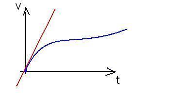

If a certain motion started at t=0 with initial velocity v(0), and you want to find the instantaneous acceleration at t =0 you need to measure the velocity at later instants, t=0+Δt. Of course, you can not measure before the start, but the acceleration at zero is defined as the limit Δv/Δt = (v(t)-v(0))/Δt when Δt →0 through positive values.
If you plot v(t) in terms of time, you can draw a tangent to the v(t) curve at t=0. Its slope is the acceleration at t=0. That is true either v(0)= 0 or not.

Thanks ehild , Infinitum , ILS and azizlwl for your excellent replies !
That's were the replies I was expecting !
Now I get it theoretically , graphically and mathematically as well.
Thanks again.
