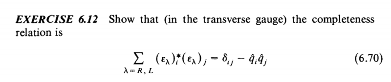

Hi
Would you explain to me what is the q^ and how they are related to completeness.How can i solve this exercise?It is from "Quarks and leptons An Introductory course in Modern Particle Physics" of Halzen and Alan D.Martin.Also, can you point me to a useful bibliography?
Printed textbook exercise 6.12: show that in the transverse gauge the completeness relation is sum over lambda = R, L of (epsilon_lambda)_i* (epsilon_lambda)_j = delta_ij - q_i q_j, labelled equation (6.70).
Just write down the definition of the ##\epsilon_{\lambda}## and do the calculation by "brute force" (it's not too difficult).
