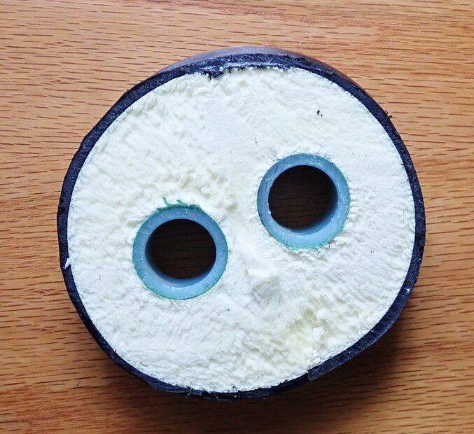

Are the water pipes to the house insulated? If not, there is a product specifically designed for this application. I don't know any trade names, but a photo of a piece of the water lines to my workshop is below:
Two lengths of 3/4" ID tube inside a 4" diameter plastic sleeve.
If there is noticeable heat from the boiler inside its building, then that building should be insulated. It's too late now, but that slab should have at least 4" foam underneath it.

Without knowing the specifics, I would say that insulating the pex lines will give you the bigger bang for your buck.
As has already been stated, adding thermal mass (your fire bricks) will not alter the total amount of heat available, but insulating the pex lines will waste less of that heat energy.
