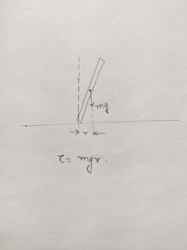

A uniform rod is kept vertically on a horizontal smooth surface at point O. If it is rotated slightly and released, it falls down on the horizontal surface. The lower end will remain:
(a) at O.
(b) at a distance less than ##l/2## from O.
(c) at a distance ##l/2## from O.
(d) at a distance larger than ##l/2## from O.
##\tau=I\alpha##
According to me, (a) is the correct answer. However, it's not the right answer according to the book I'm reading.
My understanding is that about point O, there will be a torque due to rod's weight, which will rotate the rod about point O. For eg, if I take a pencil and make it stand vertically on the table, and then rotate it slightly and then release it, it's bottom most point which touches the surface will not move, the whole pencil will rotate about the point O due to torque due to its weight. As such, the lower end will remain at point O.
But my answer is wrong according to the book.
Can someone please tell why my answer is wrong ?

Same diagram will be applicable for both, the pencil and the rod. I took the example of pencil as it can also be construed as a uniform rod.
Yes, the diagrams may be the same, but what about the forces? Suppose the tip stays at point O as you say. When the rod/pencil is at an angle and rotating about O, what force is needed to keep the center of mass going in a circle? What agent outside the rod/pencil system can exert such a force?
The forces are different. Three forces on the pencil. Two forces on the rod.
Hint: Once you've sussed-out the forces, you can work out what happens to the rod's centre of mass and the problem becomes trivial.

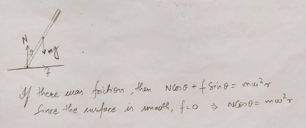

I was assuming the pencil to be standing on the smooth surface as well, hence the two forces.
However, in post#5, as a component of Normal force provides the required centripetal force, why wouldn't the CoM move in a circular trajectory ?
I agree that to get the CoM to move in a circular trajectory, you will a centripetal force component. Where would that component come from? If there no friction, the table can only exert a force straight up, perpendicular to the surface and gravity is antiparallel to it straight down. Neither has a horizontal component. In post #5 there should be no friction and therefore no N cosθ.
@kuruman, I understand that there is no friction, but why have you written no friciton therefore no N##Cos\theta##. What is wrong in taking a component of a force at an angle to the line of action of the force. Isn't it just separating the components in a particular direction ?
As I hinted in post #7, the simplest approach here is to think about the net horizontal force and consequent horizontal acceleration of the mass centre.
A vertical force has no horizontal component by definition. Both forces in this example are vertical.
No, it would point radially up, not radially down.
And you cannot be sure there is a centripetal force here.
@haruspex, Yes N is upward i.e. Normal to the surface. Even then, why can we not say that NCos##\theta## is providing the centrifugal force given by NCos##\theta##=##mw^2r## ?
You previously said centripetal force, so first we need to clear up what these two things are.
Centrifugal force is an apparent force that results from using a noninertial frame. It is not an actual force, so is not provided by any combination of applied forces. If spun in a drum, you notice a normal force from the wall, but, in your frame of reference, you are not accelerating, so to explain the unbalanced normal force your brain invents a force pushing you against the wall.
Centripetal force is real, but it is not a specific applied force or sum of such: it is that component of the sum of applied forces which acts orthogonally to the velocity.
In the present situation, you cannot assume that the sum of applied forces has a component orthogonal to the velocity of the mass centre, so you cannot assume there is a centripetal force.
If you suppose the rod is rotating about an axis below its mass centre then the centripetal force must be acting at some downward angle. The normal force from the ground clearly does not do that. Indeed, if we say instead that there is friction to hold the base of the rod in place then it is the gravitational force force that supplies the downward component of the centripetal force.
But, please, can we set aside all this discussion of centrifugal/ centripetal forces until we have solved the question at hand by the very simple approach of applying F=ma to the horizontal aspects?

As haruspex explains, you mean 'centripetal'. However, forget about the rotation until you can answer these 2 simple questions:
Q1. What is the direction of the resultant force on the rod while it topples?
Q2. Therefore what happens to the rod's centre of mass while it topples?
@Steve4Physics, the resultant of net force is downward, hence the CoM goes down, but mg creates a torque about the point at which the rod touches the surface.

@haruspex, If we use F=ma, then since there is no force/neither a component of any force in the horizontal direction, therefore the CoM must not move in the horizontal direction. I get that. But why is it difficult to explain /understand from rotation point of view.
If we take the FoR of the rod itself, then it is a non-inertial FoR. Therefore it could be said that NCos##\theta## is providing the centrifugal force, and therefore the CoM must move in circular trajectory, i.e. the rod will rotate about point O.
Yes, the resultant force is vertically downwards, so the CoM accelerates vertically downwards. Can you answer the original question now?
Understanding the rotation is much much complicated. The rod has both a resultant force and a couple acting on it; neither of these is constant which makes analysing the rotation tricky. Considering rotation about the centre of mass, the couple is entirely due to the normal reaction . However both the magnitude and lever-arm of the normal reaction change over time. But to answer the original question, this is irrelevant.
@Steve4Physics, I can answer it like this: Since no component of force in horizontal direction, therefore no movement of CoM in horizontal direction.

If we are in FoR of rod itself, then will NCos##\theta## not provide the centrifugal force of ##mw^2r## ? Why won't it.?
But I wish to understand it in totality, not just in one way, as in no horizontal force, therefore no horizontal acceleration, therefore no horizontal movement. I also need to understand it in terms of rotation.
You first need to to read haruspex's post #18 to understand why it is a serious mistake to use the term 'centrifugal force' here.
Yes, at any instant Ncosθ is the centripetal force. But note N is not constant which complicates the maths. If you want to investigate the maths more deeply, do a search for 'rod falling on frictionless surface'.
Yes. There is a torque associated with the force of gravity. There being no other forces on the rod that have associated torques, that means that this torque is, at least initially, equal to the net torque on the rod.
That means that the angular momentum of the rod will be changing over time.
What it does not mean is that the rod will be moving horizontally. There is a way that the rod can change angular momentum without moving horizontally -- it can rotate about its center of mass.
Since horizontal motion of the center of mass is ruled out by other arguments, we can be sure that this rotation is at least part of what actually happens.
Note that vertical motion motion of the center of mass also adds to angular momentum about the initial contact point since the center of mass is not on a vertical line with that contact point. Angular momentum is not just about rotation.
