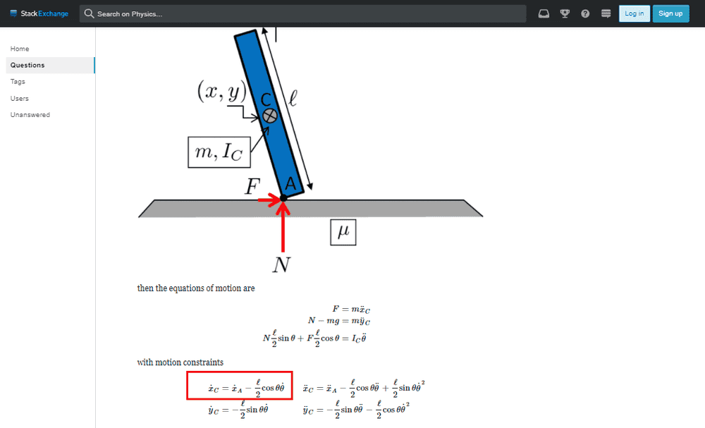

@haruspex, In the non-inertial FoR, centrifugal force IS the cause. How could it ever be an effect. For eg.: If an ant begins his life inside a rotating cylinder, will he not experience centrifugal force as a cause by which it is sticking on the inside surface of the cylinder.
In the article in the link provided by @Steve4Physics in post#24: https://physics.stackexchange.com/q...od-with-one-end-touching-a-frictionless-surfa
can somebody please explain how the equation (marked in red rectangle) has been arrived at in the attached file below.
  • #33
It's quite simple. It says that the forward velocity of the center of mass (point C on the rod) relative to the ground is equal to the forward velocity of the point of ground contact A minus the linear velocity of point C as it rotates counterclockwise relative to point A.
Note that this is a different physical situation from what we have here where there is no external force ##F## applied at point A. Therefore, here ##\ddot x_C=0##. To repeat what has already been said, if the horizontal acceleration is zero and the rod is initially at rest, point C will not move horizontally. In terms of the constraint equation in the red rectangle this means that $$\dot x_C=0~\Rightarrow~\dot x_A=\frac{l}{2}\dot \theta\cos\theta.$$
