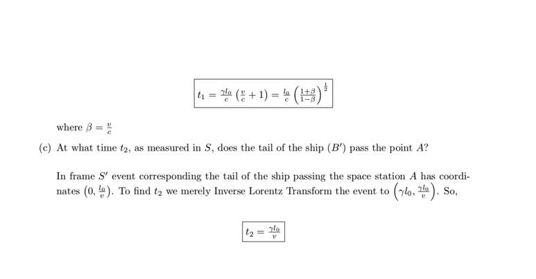

Part (C), The book contends ##\gamma## should be in the denominator where as I think it should be in the numerator$$
The Lorentz Transform (see below)
Text page of a relativity problem 4.5 with a labeled rocketship diagram above a solution section; the diagram shows the ship moving right at velocity v with nose A' and tail B' and a point A marked in frame S.
Typeset physics working: boxed expression for t1 equal to gamma l0 over c times (v/c + 1) equal to l0/c times square root of (1+beta)/(1-beta), with beta = v/c; part (c) text and boxed result t2 = gamma l0 / v.

Printed text reading: In frame S' event corresponding the tail of the ship passing the space station A has coordinates (0, t_0/v), with the coordinate pair circled in orange.
Check this.

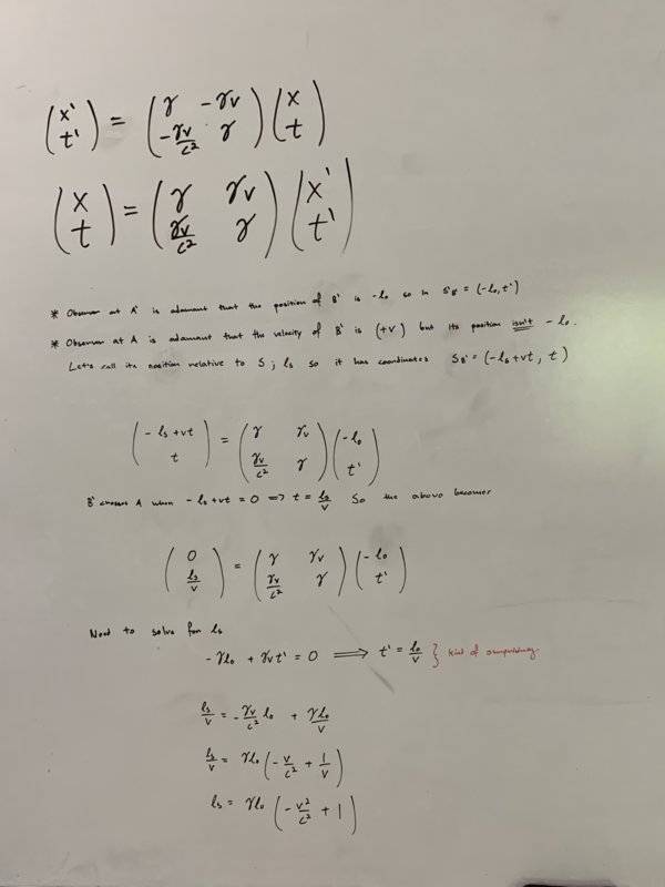

Alright, I think I got it and it doesn't make the least bit of sense but here we go. I want to practice using Lorentz Transforms instead of time dilation and length contraction formulas.
Event 1: is when ##A'## crosses ##A##. The coordinates for these in the station frame and ship frame are ##S_1 = \left( 0,0\right)## and ##S'_1 = \left(0,0\right)## respectively.
Event 2: is when ##B'## crosses ##A##. The coordinates for these in the station frame and ship frame are ##S_2 = \left( 0,t_2\right)## and ##S'_2 = \left(-\gamma v t_2,\gamma t_2\right)## respectively where ##S'_2## is found by Lorentz Transforming ##S_2## according to
##x' = \gamma x - \gamma v t##
##t' = - \frac{\gamma v}{c^2} + \gamma t##
But ##\gamma t_2 = \frac{l_0}{v}##. So, therefore ##t_2 = \frac{l_0}{\gamma v}##.
I actually think this is wrong since I made the same mistake that you warned me about but I somehow got the right answer. I can't physically reconcile the last step, all I know is that it gets me the right answer.
It should be easy to write down the space and time coordinates for the second event in the primed frame. They are easily expressed in terms of ##l_0## and ##v##. In your first post, you have the correct expression for the time coordinate of this event in the primed frame. But, you mistakenly wrote the space coordinate as ##0##. What is the space coordinate of the tail of the ship in the primed frame (at any time)?
##- l_0##? I say minus because in my mind it's to the left of the origin of ##S'##.
Yes.

I'm afraid I don't follow when I take the event ##S'_{B'\:crosses\:A} = \left( -l_0, \frac{l_0}{v}\right)## and transform it to ##S## I get ##S_{B'\:crosses\:A} = \left( -\gamma l_0 - \gamma l_0, -\frac{\gamma v}{c^2}\left( \frac{l_0}{v}\right) + \frac{\gamma l_0}{v}\right) = \left( 0, \frac{\gamma v}{c^2}\left( \frac{l_0}{v}\right) + \frac{\gamma l_0}{v} \right) ##, but the time coordinate of this event in ##S## isn't ##\frac{l_0}{\gamma v} ## (The answer that the book gets).
I'm going to continue to work on this problem throughout the day. I need to think more about what is actually happening instead of just plugging and chugging imo anyway.
Alright I think I got it by really slowing down to think about it. There's still one part I haven't reconciled with intuition. Namely ##t' = \frac{l_0}{v}## when ##B'## crosses ##A## because it almost looks classical; ##v## is the speed of ##B'## in ##S## and ##l_0## is proper length. Don't quite get it. I'll think about it some more.Now for the solution handled as generally as possible.
Start with equations.
(x′t′)=(γ−γv−γvc2γ)(xt)(x′t′)=(γ−γv−γvc2γ)(xt)
(xt)=(γγvγvc2γ)(x′t′)(xt)=(γγvγvc2γ)(x′t′)​
1) Observer at ##A'## is adamant that the position of ##B'## is ##-l_0## so we have ##S'_{B'} = \left( - l_0, t' \right)##
2) Observer at ##A## is adamant that the velocity of ##B'## is ##(+v)## but its position isn't ##-l_0##. Let's call the position of ##B'## in ##S##; ##l_s## so it has coordinates ##S_{B'} = \left( -l_s + vt, t \right)##.
(ls+vtt)=(γγvγvc2γ)(−l0t)(ls+vtt)=(γγvγvc2γ)(−l0t)​
##B'## crosses ##A## when ##-l_s + vt = 0 \Rightarrow t = \frac{l_s}{v}##
(0lsv)=(γγvγvc2γ)(−l0t)(0lsv)=(γγvγvc2γ)(−l0t)​
We need to solve for ##l_s##
−γl0+γvt′=0⇒t′=l0v−γl0+γvt′=0⇒t′=l0v​
The above part is kind of surprising for aforementioned reasons
lsv=−γvc2l0+γl0vlsv=−γvc2l0+γl0v
lsv=γl0(−vc2+1v)lsv=γl0(−vc2+1v)

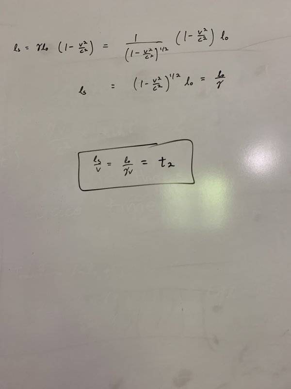

ls=γl0(−vc2+1)ls=γl0(−vc2+1)​
$$l_s = \gamma l_0 \left( 1 - \frac{v^2}{c^2} \right) = \gamma \left( \frac{1}{\gamma^2 \right) l_0 = \frac{l_0}{\gamma}$$
As mentioned earlier ##t = \frac{ls}{v}## so we have
t2=l0γvt2=l0γv​
From S' viewpoint, the point A (in S) moves to the left with speed v and the distance A must travel to get from the front to the back of the ship is the length of the ship in S'.
