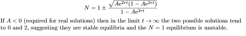

Trying to understand this limit:
where ##r>0##
[/B]
I think it's best to proceed by writing this as:
## N=1 \pm \frac{\sqrt{Ae^{2rt}}}{\sqrt{1-Ae^{2rt}}} ##
[/B]
since ##r>0 ## the exponential term ##\to ## ##\infty## and then since ##A<0## I get two results for ## lim_{t \to \infty} Ae^{2rt} ## depending on ## |A| ##.
a) If ##|A| < 1 ## it goes to zero.
if b) ## |A| \geq 1 ## it goes to ##-\infty##
and where the magnitude of A is not specified in the question.
If it was however for case a) the limit is of an determinate form: ##1 \pm \frac{0}{1} = 1 ##
however for b) i get ## 1 \pm \frac{\sqrt{-\infty}}{\sqrt{1+\infty}}## , and I can't see L'Hopitals rule being much use here due to the square root and exponential terms.
Many thanks in advance.

$$f(t) = \frac{\sqrt{A e^{2rt}}}{\sqrt{1-Ae^{2rt}}}
= \frac{e^{-rt}}{e^{-rt}} \frac{\sqrt{A e^{2rt}}}{\sqrt{1-Ae^{2rt}}}
= \frac{\sqrt{A}}{\sqrt{e^{-2rt} - A} } \to \frac{\sqrt{A}}{\sqrt{-A}}$$
but A<0, so the numerator is not real?
Right, but no less real than the original form ##\sqrt{A e^{2rt}}##.
so then do we not get ## 1 \pm i ## rather than ## 1 \pm 1 ## as in the solution above?
