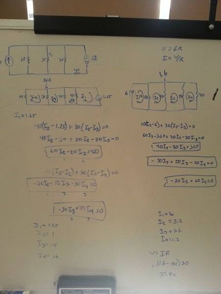

Ok, can anyone tell me if my steps are correct. Find volts in the 30ohms
part1
1. eliminate current source
2. transform battery to current source
3. applied mesh method to find current at 30ohms
part2
1. eliminate battery source
2. applied mesh method to find current at 30ohms
part3
1. to find the current at 30ohms I substracted the current that I got from doing part 1 and doing part 2 to get the actual current at the 30ohms
2. Finally used ohms law to find voltage
Is this correct? I know there are easier ways but I did it this way

Your loop equations all look okay, but something seems to have gone wrong with your determination of I4 in the first part (where you suppressed the current source and converted the voltage source).
Why not consider combining the parallel 20, 40, and 60 ohm resistors to begin with; it'd make your analysis simpler.
