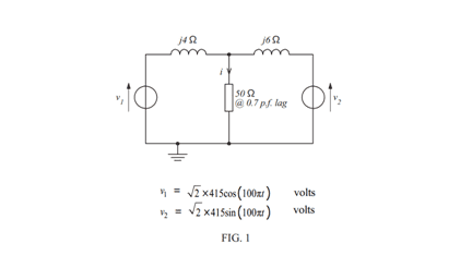

FIGURE 1 shows a 50 Ω load being fed from two voltage sources via
their associated reactances. Determine the current i flowing in the load by:
(a) applying Thévenin’s theorem
(b) applying the superposition theorem
(c) by transforming the two voltage sources and their associated
reactances into current sources (and thus form a pair of Norton
generators)
(a)
Converting V1 & V2 to RMS values and V1 to a sin value:
V1 = 415sin(100πt+90)
V2 = 415sin(100πt)
and from Asin(ωt+Φ)
V1 = 415∠90V or 0+j415 V
V2 = 415∠0V or 415+j0 V
Then current around the circuit:
I =V/Z = (V2-V1) / (Z2+Z1) = (415-j415) / (j10)
This as a polar form division:
586.8986∠-45 / 10∠90 = 58.68986∠-135 A or -41.5-j41.5
Vt = V2 - Z2*I = 415+j0 - (0+j6)(-41.5-j41.5) = 415+j0-(-j249-249j^2) as j^2 = -1 then:
Vt = 415-(249-j249) = 166+j249V
ZL = 50@0.7lag = 50∠-45.572998 = 35+j35.70714Ω
Zt = j4in parallel with j6= j2.4
so load current:
I = V / ZL + Zt = 166+j249 / ( 0+j2.4 + 35+j35.70714 ) = 166+j249 / 35+j38.10714
this as a polar division I = 299.26∠56.310 / 51.741∠47.434 = 5.784∠8.876A
I have only completed part (a), once I know I'm on the right track I'll complete b & c. All help is greatly appreciated as always.

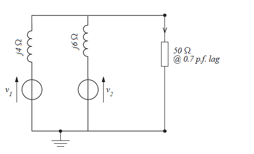

Jason-Li, Just wondering here...for your calculation for figuring out the current around the circuit, does that still hold up for the load being a short? Open? Dan
Hi dvscrobe, I am not going to lie to you this circuit is confusing me, I'll give it a bash though. I have redrawn (on paint) the circuit like below. So if I were to say that the load is shorted then could I use KCL so that:
I3 = I1+I2
= 415∠90/ / 4∠90 + 415∠0 / 6∠90
= 103.75∠0 + 69.167∠-90
= 103.75-j69.167A
Which is different to my calculated -41.5-j41.5 A but I could then do
Vab = I3 * Zt
=(103.75-j67.167) * j2.4
= 166+j249
Which is the same as my earlier Vab figure?
All help is much appreciated.

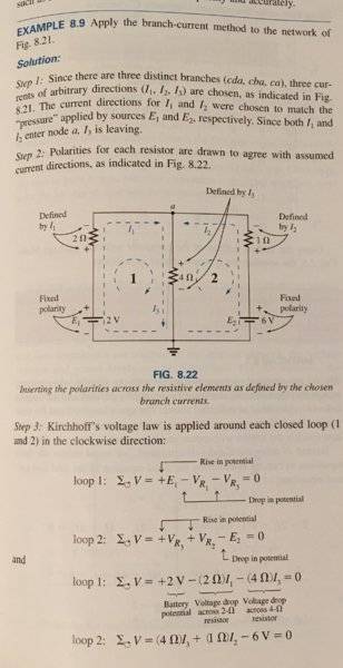

Jason-Li, I liked how you simplified things up a little to start the problem. Finding the RMS value, phase shift, and frequency was pretty easy. When you were trying to calculate the current in the outer loop, that won't work. When going around the outer loop, first loop, and second loop, you can use Kirchoff's Voltage Law by summing the voltage sources and voltage drops. For currents, consider the nodes. You have one on the top part of the load and one on the bottom part of the load. Current in must equal current out. Kind of like a current differential relay in a substation. You essentially have 3 current variables. I1 though the first voltage source, I2 through the second voltage source, and I3 through the load. I1 & I2 basically sums up to go into the load and becomes I3. It takes a little algebra to get it. Dan
Hi Dan,
I'm not sure what loops you are meaning when you say I can't calculate that way? If I1 & I2 are from V1 & V2 respectively does that not mean that I3 is the current in the load as I3 goes into the node prior to the load hence must leave it?
Also if it isn't possible to do this unsure of why The value of Vab worked out the same on both methods?
Thanks for the help.
Jason-Li, Here is what I mean by loops. Taken from my favorite book on circuit analysis. Dan.
Dan, I see what you mean so I could treat it sort of like mesh analysis, so if I redo it as follows:
Assuming all currents are clockwise (for ease)
Loop 1:
V1-Z1*I1-ZL(I1-I2)=0

Hi Dan, I know its a lot of reading, but is the following method okay? (if so ignore the previous 2 posts)
Thevenin equivalent reactance: j2.4
With V30 being the centre node:
(v1-V30)/Z1+(V2-V30)/Z2=0
V30=(V1*z2+v20*Z1)/Z1+z2)
= (j415*j6+415*j4)/(j4+j6)
=166+j249
Current in the load:
I=V/(Zt+ZL)
=(166+j249) / (j2.4+35+j35.10714)
= 5.784∠8.876A
This is using nodal analysis and I still get the same answer? Does this mean that the answer is proved or am I so far off the mark its ridiculous?
Jason-Li, I took at a stab at this and it may be time to call in the experts. I don't think I got the correct answer. Sorry. Works much better with DC circuits. I use a TI-86 that let's me plug values into a variable. So a letter with a box around it is a variable that I programmed. Unfortunately, my current from the 2nd voltage source on the right is higher in magnitude than the current from the 1st voltage source on the left. Your problem has a higher inductive reactance on the right side (j6) than that of left side (j4). Hopefully, someone else can chime in, cause now I got myself wondering. Dan
I've looked through it a couple of times and I don't see where you calxulate the Thevenin impedance = (open ckt voltage) ÷ (short ckt current).
I'm on my phone, so maybe I missed it. It looks like the purpose of this exercise is for you to calculate it 3 different ways, and if you did it correctly, then you'll arrive at the same answer.
It also exposes to different methods, because some methods are better suited for some circuits than others.
Hi scottdave,
I calculated the Zt by calculating Z1 & Z2 as in parallel as the voltage sources won't have impedences. Hence Zt = J2.4.
Pretty certain that's correct?
I'm with you there. You just calculated the Thevenin resistance. I agree with (0+j2.4). Dan
Ok I did find where you showed Zt as j6 in parallel with j4Ω is j2.4Ω. I confirm the same value doing it the way I learned (open ckt voltage) ÷ (short ckt current).
Ok thanks.
Does the rest of it look like correct methodology & answer to you?
Put me and Dan out of our misery haha.
