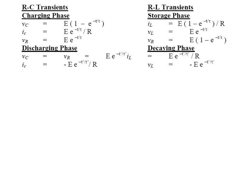

A series R-L transient circuit is connected to a voltage source of E= 40V through a switch as shown. Suppose the switch is closed at time t=0μs and it was observed that the current iL flowing through the inductor rises to 4mA at time t=20μs and remains at 4mA after t=20μs.(i) Find the R-L time constant τ in μs for the storage phase. Resistor given is 10kΩ
iL=E/R(1-e-t/τ)
0.004=40/10000(1-e-20x10-6/τ)
0.004=0.004(1-e-20x10-6/τ) -> 0.004-0.004=0
0=-e-20x10-6/τ -> Wanted to take ln for both side, ln 0 =error
unable to continue, please help, thanks.(ii) Calculate the amount of energy Wl in nJ, stored in the inductor after 1 minute.

Yeah, the exponential term has to decay to 0 in order for the current to approach the asymptotic value of E/R. This happens when the exponent "blah" is large enough that e^-blah = 0. (To put it loosely: (-20 us)/tau → ln0 ≈ -infinity). So the time of 20 us is much much larger than a time constant, so that the exponent will be much larger than -1, and you have many factors of "e" of decay. Typically in these engineering classes they give you a "rule of thumb" that says that you can consider the exponential to have effectively decayed to zero after n time constants. I'm inferring from you comment in part ii that your class is taking n = 5 as your rule of thumb. If that's true, you can solve for tau by assuming that the 20 us is = 5 time constants. Without such a rule of thumb, you can't really solve for a specific value of tau, all you can say is that tau is much smaller than 20 us.

You're trying to find ##\tau## such that e-20x10-6 = 0. But the function ##e^{-x}## only approaches zero asymptotically as x goes to infinity. You can't find τ exactly by this method. Use the "excitement's over after 5τ" rule of thumb instead.

You're told that the current reaches essentially steady state after 20 μs. So τ must be less than 20 μs. In fact, it's about 5 times smaller than 20 μs.

"Suppose the switch is closed at time t=0μs and it was observed that the current iL flowing through the inductor rises to 4mA at time t=20μs and remains at 4mA after t=20μs."
