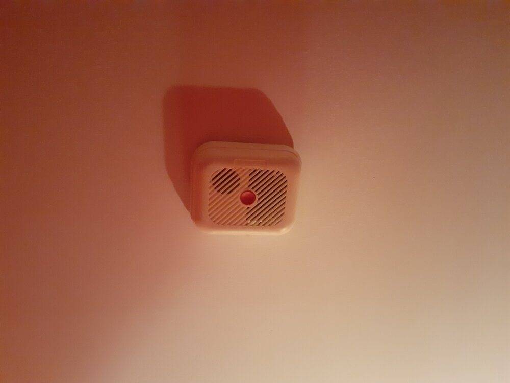

Also can dust/alpha escape the slats at the sides of the ionisation chamber?
Here is what my detector looks like attached.
I would expect zero dust. The Americium is encapsulated in a coating.

spark90 said:
As my smoke detector is 27 years old I was worried health and safety wasn't as good then.
Well that's a concern; please check it, because it may have a 10-year lifespan. That's a significant safety risk if it is expired.
As dust from the inside of the cover could have been inhaled when falling into my eyes, are you aware of whether when americium decays over the years does it produce dust...
It does not.
It's not dust. Yes, at least some of the alpha particles escape.
