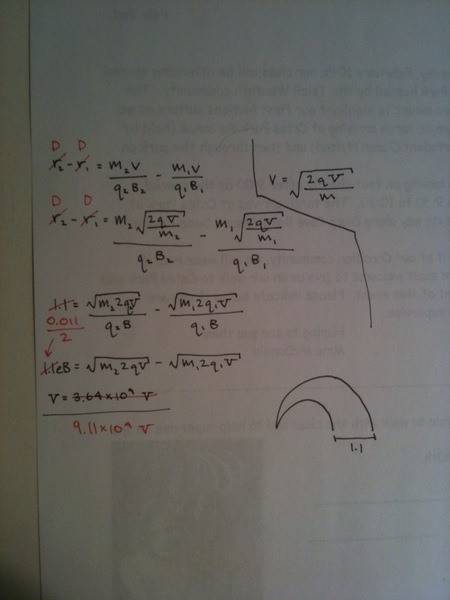

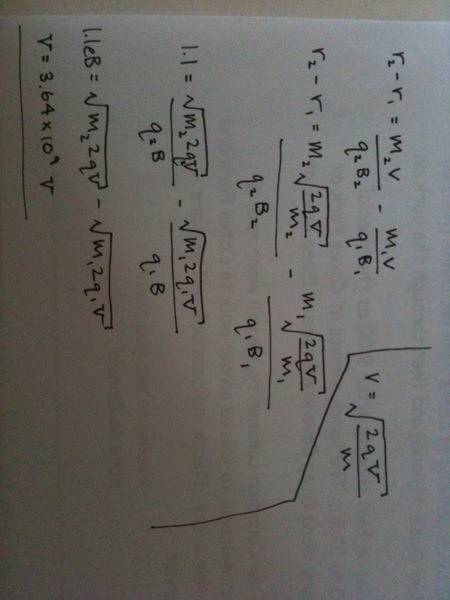

I tried to use latex but it got a little to crazy for me. A photo of my work is attached.
The solution I get for voltage I get is huge. I think something is wrong.
(I converted amu to kg for the masses of the particles and used e for the charges)

That's pretty good, you're almost there, just a couple of problems to iron out:
1. Watch the units, the separation is not 1.1 meters.
2. The separation of the two charges is not simply equal to the difference in radii. Try drawing a picture; the two charges start from the same point and each travels 1/2 of a circle. What is their separation, in terms of radius or diameter, after going 1/2 way around the circle?
You nearly have it.
I still get a rather large number (9.11*104 V). Is this what I should expect?
9.22*104 V is not correct.
Everything looks good to me. Although I still don't see how the same potential difference can accelerate two particles of different masses to the same speed.
I am supposed to give my answer in MV so a large number is expected.
