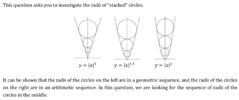

Radii of stacked circles inside the graph of y = |x|^1.5
The discussion revolves around the problem of determining the radii of stacked circles within the graph of the function y = |x|^1.5. Participants are exploring the relationships between the radii as they approach a limit, particularly focusing on the behavior of the circles as their radii become large.
  • Mixed
  • Participants discuss using geometrical arguments and limits to analyze the relationship between the radii of the circles. There are attempts to rationalize expressions and derive limits, with some participants expressing uncertainty about their methods and results.
The discussion is ongoing, with various approaches being explored. Some participants have provided hints and suggestions for proving certain parts of the problem, while others are questioning the validity of their reasoning and the assumptions made in their calculations.
There is an emphasis on the limit as the ratio of the radii approaches 1, which raises questions about the independence of the variables involved. Participants are also grappling with the implications of large values for the radii and how that affects their calculations.

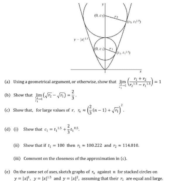

(a) The hint from question is to used geometrical argument. From the graph, I can see ##r_1+r_2=c_2-c_1## but I doubt it will be usefule since the limit is ##\frac{r_2}{r_1} \rightarrow 1##, not in term of ##c##.
I also tried to calculate the limit directly (not using geometrical argument at all).
$$\lim_{\frac{r_2}{r_1} \rightarrow 1} \left(\frac{r_1+r_2}{{r_2}^{1.5}-{r_1}^{1.5}}\right)$$
$$=\lim_{\frac{r_2}{r_1} \rightarrow 1} \left(\frac{1+\frac{r_2}{r_1}}{\frac{{r_2}^{1.5}}{r_1}-{r_1}^{0.5}}\right)$$
Then got stuck
I also tried rationalization:
$$\lim_{\frac{r_2}{r_1} \rightarrow 1} \left(\frac{r_1+r_2}{{r_2}^{1.5}-{r_1}^{1.5}}\right) \times \frac{{r_2}^{1.5}+{r_1}^{1.5}}{{r_2}^{1.5}+{r_1}^{1.5}}$$
$$=\lim_{\frac{r_2}{r_1} \rightarrow 1} \left(\frac{(r_1+r_2)({r_2}^{1.5}+{r_1}^{1.5})}{{r_2}^{3}-{r_1}^{3}}\right)$$
$$=\lim_{\frac{r_2}{r_1} \rightarrow 1} \left(\frac{(r_1+r_2)({r_2}^{1.5}+{r_1}^{1.5})}{(r_2-r_1)({r_2}^{2}+r_1 r_2+{r_1}^{2}})\right)$$
Then stuck again
Please give me hint, especially how to use geometrical argument.
Thanks

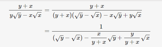

This isn't a method. It's a heuristic at best. I get with the use of ##(c)## and for the sake of less typing with ##x=r_n## and ##y=r_{n+1}##
\begin{align*}
\dfrac{y+x}{y\sqrt{y}-x\sqrt{x}}&=\dfrac{y+x}{(y+x)(\sqrt{y}-\sqrt{x})-x\sqrt{y}+y\sqrt{x}}\\[6pt]
&=\dfrac{1}{(\sqrt{y}-\sqrt{x})- \dfrac{x}{y+x}\sqrt{y}+\dfrac{y}{y+x}\sqrt{x}}\\[6pt]
&\stackrel{(y/x)\to 1}{\longrightarrow }\dfrac{1}{\sqrt{y}-\sqrt{x}-(1/2)\sqrt{y}+(1/2)\sqrt{x}}\\[6pt]
&\stackrel{(y/x)\to 1}{\longrightarrow }2\dfrac{1}{\sqrt{y}-\sqrt{x}}\stackrel{(y/x)\to 1}{\longrightarrow }3
\end{align*}
Not sure whether I made a mistake.

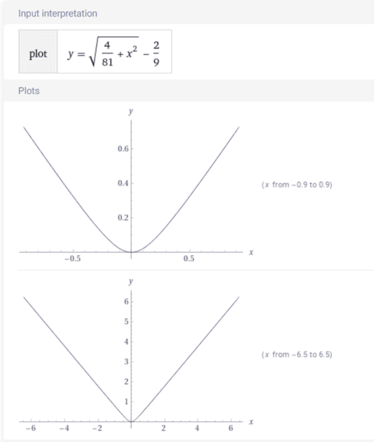

From geometry I observe
Relation of t >0 and r, evaluating line equation and length of r,
[tex]t=-\frac{2}{9}+\sqrt{\frac{4}{81}+r^2}[/tex]
Recurrence formula with t from ##c_2-c_1=r_1+r_2##
[tex]c_2-r_2=c_1+r_1[/tex]thus
[tex]3t_{n+1}^{3/2}-\sqrt{13}t_{n+1}+6t_{n+1}^{1/2}=3t_{n}^{3/2}+\sqrt{13}t_{n}+6t_{n}^{1/2}[/tex]
if I do not make mistakes.
