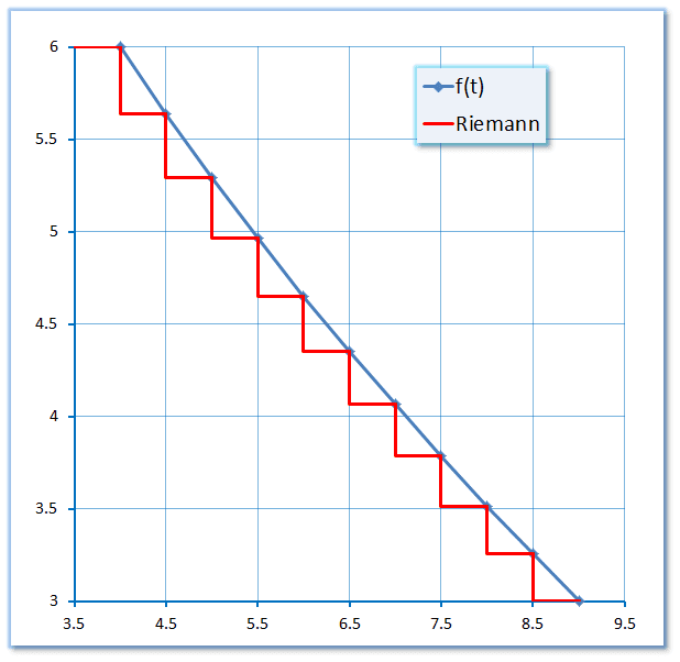

(a) I imagine there are several rectangles to represent the area under graph of p vs t then I try to make equation for the total area. Since the question asks about time when the container holds 22 fewer liters than it does at time t = 9, I think the total area of rectangles starting from t = b until t = 9 will be 22 liters, where b is the time I want to find. So:
$$\Sigma_{t=b}^{9} ~ f(t).\Delta t=22$$
Is that correct?
(b) I tried to calculate the area of rectangles using the right end-point and add the area starting from t = 9 and going backwards until I get the total area = 22. I did it twice, one by using Δt = 1 but I felt this is not accurate enough so I did it again using Δt = 0.5

So the approximate time is t = 4 hours
Is that correct?

Hello again,
I understand the function is given as ## \ p(t) = 3-\sqrt t\ ## in the exercise, not only for part b), but also for part a) ?
I wonder why your table is ascending order in time (somewhat confusing , at least for me :smile: ).
From column 3 I gather you approach the integral as a lower Riemann sum (red line). There is also an upper Riemann sum, and the integral is more closely approached if you take the average of the two ...
You mean descending in time? I tried to find the total area to be equal to 22 starting from t = b to t = 9 so I think it will be easier for me if I do it backwards, starting from t = 9
You mean the approximation will be better if I use the midpoint of the rectangle (rather than the left end-point or the right end-point) ?

And I think you are correct. So the answer for part a) is most likely something in the form of $$22\; \text {L} \ = \int_{t_1}^{t_2}f(t)\, dt$$ ...
So in part b i) you are asked to approximate and that means you can do as you did. Indeed, average of upper and lower sum is more accurate. (Even more acurate will be using Simpson's rule)
Is that correct?
Doing the integral shows it is the exact time, so: yes.
