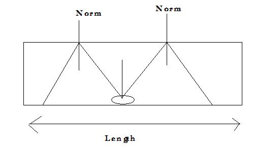

There's a lamp in the bottom of the lake. If you watch the lamp from the surface(out of the water) and your eyesight is crossed with the lake, you can see a bright circle. Radius of the circle is 10 meters. Refractive index of the water is 1,33. how deep in the water the lamp is.
I don't completely understand the question :redface:,
but it looks as if it's about the angle of total internal reflection. :wink:​
pictures always help in my opinion, and you use what Tiny-Tim stated
Diagram of a light ray in a rectangular block: it enters at the left-hand normal, reflects off the bottom surface at a small oval point, and exits at the right-hand normal, with the block length labelled below.
