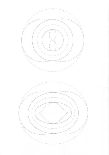

This is one reason why I favour elliptical coordinates. The idea that the ring singularity resides between r+ and r- doesn't seem right as this is spacelike and technically no stable r is possible. Using the following simple equations establishes elliptical coordinates and always puts the ring singularity within r-.
[tex]x=\sqrt{r^2+a^2}\sin \theta[/tex]
[tex]y=r \cos \theta[/tex]
Attached are two images for a black hole with a spin parameter of a/M=0.95. The top image uses regular spherical coordinates while the bottom image uses elliptical coordinates and defines the ring singularity with a coordinate radius of [itex]a[/itex] while the singularity still resides at r=0 and [itex]\theta=\pi/2[/itex]. This also implies there is a new region of space (or extended Kerr geometry) at r<0.
I think I've seen one image where the ring singularity is between r+ and r- but I think the general census is that if it were to exist, it is within (or at maybe) r- unless there is some mathematical trick that allows it to hover at a specific radius within spacelike space which would be synonymous to something hovering at say 3.00pm in timelike space.
