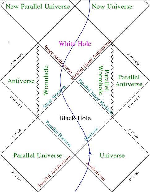

But I need to provide some cautions about that "Big Think" article: It provides much lighter reading, but it also includes material that goes beyond Kerr's paper. For example, the Big Think article includes this revised Penrose Diagram:
This diagram is not described or referenced in Kerr's article. Nor does Kerr's article mention worm holes.
The first thing I noticed with that diagram is the missing "You are Here" tag. And If you ever wondered how to visit the interior of a Black Hole and live to tell about it, then place that "you are here" tag in the "New Universe". Then you can wonder what will become of all this "new matter" coming into your "New Universe" once Hawking Radiation evaporates the Black Hole in the "Universe" that it was borrowed from.
Yes. What's more, Kerr dismisses maximal analytic extensions in the paper as not being useful. I think he is mistaken, and the mistake is relevant to at least one thing he discusses in the paper.
One very useful aspect of Penrose diagrams like the one you posted, which are derived from the maximal analytic extensions of various spacetimes, is not that they are generally physically realizable (for various reasons, some of which I have stated in previous posts and some of which Kerr discusses in the paper, they're not considered to be), but that they give a valuable framework for constructing models of gravitational collapse to a black hole that are physically realizable, by showing what constraints any such models have to meet.
The reason for this is that any realizable model of gravitational collapse to a black hole must have a vacuum region that is the same as some portion of the Penrose diagram of the appropriate maximal analytic extension. In other words, we must be able to draw a timelike line on the diagram that marks the boundary of the non-vacuum region (it must be timelike because the surface of the matter that is collapsing must collapse on timelike worldlines), and that line must cross the event horizon at some finite point (otherwise the entire black hole region is eliminated and we just have a model describing an ordinary object).
For example, for the 1939 Oppenheimer-Snyder model of the collapse of dust (zero pressure matter) to a Schwarzschild black hole, we would draw a boundary on the Penrose diagram of the maximal extension of the Schwarzschild geometry that would look similar to the one drawn on a Kruskal diagram in this Insights article:
https://www.physicsforums.com/insights/schwarzschild-geometry-part-4/
Now Kerr, in the paper, discusses models of collapse to a Kerr black hole in which the deep interior does not contain any ring singularity at all, but instead contains a stable object with a surface at some radius ##r > 0##. But if you try to draw the boundary of the non-vacuum region for such a collapse on the Penrose diagram you posted in the OP of this thread, you will find that it is not possible. Consider: any such timelike line will have to, first, cross the outer horizon (the event horizon) at some finite point, as noted above (otherwise we don't have a black hole at all); and second, it will have to cross the inner horizon at some finite point (because all timelike lines that cross the outer horizon must in turn cross the inner horizon; there are no timelike paths that don't do that).
But if you look at the diagram, any timelike line that crosses the inner horizon (either one--it doesn't matter whether you pick the one marked "parallel" or the other one) cannot possibly eliminate the entire ring singularity at ##r = 0## from the vacuum region. If you go up and to the left, so to speak, hoping to cross the left inner horizon as low down as possible, you can eliminate most of the left ##r = 0## line, but not all of it--but you will leave all of the right ##r = 0## line in the vacuum region (which, remember, will be the region to the right, in the diagram, of the timelike line marking the boundary of the collapsing matter). Obviously that's no good. It's better to go up and to the right, so to speak, keeping the entire left ##r = 0## line in the matter region (which means not there, because the matter region "overwrites" it)--but you still can't reach the right ##r = 0## line until some finite distance up it from the vertex where it meets the inner horizon. So some portion of the ring singularity will still be there.
