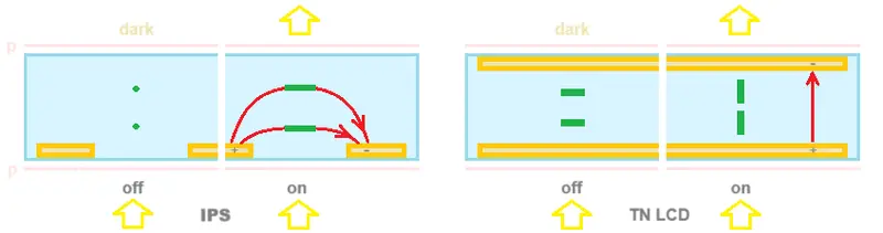

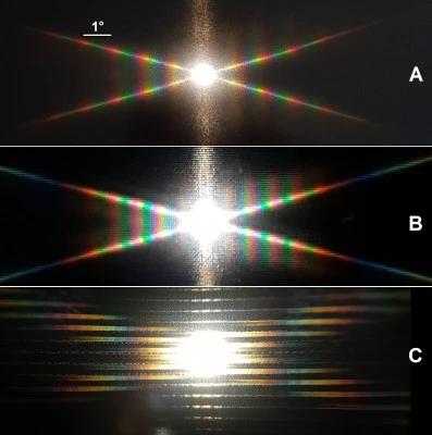

Some tv-screens, such as LG, have multiple reflective strips (electrodes?) within a pixel. The groove period of these strips is 0.03 mm, so the angle between red maxima is 1° (λ = 600 nm). In some situations that produces a rainbow effect. However you need a bright point source, such as a lamp, to see the rainbow effect. I don't think a hand would be bright enough.
I've seen that sort of thing in many situations but it always needs a bright point / line source. For a wide source, the fringes just add up to nothing except for the edges. I guess we'd need to see a photo of the original observation - else it's just guessing.

About the reflective strips: "IPS" (In Plane Switching) liquid crystal displays have "interdigital electrodes" within each pixel. That is, multiple electrode strips, and neighbouring strips are connected to opposite poles. As a result the electric field is approximately parallel to the surface of the display. In contrast, the electric field in an older type of LCD display, "twisted nematic", is perpendicular to the surface. An advantage of IPS is its wide viewing angle.
Link: 1 and 2
