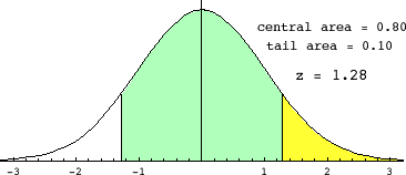

Not quite. Take a look at this figure:
If the middle (green part) of the area were 75%, what would be the areas of the white and yellow parts? And what would be the areas of the white+green combined?

Uh, no. There's 12.5% between each z-score and infinity.
Right, There will be 12.5% between infinity and each Z-score. There is 37.5% between each z-score and the mean
Don't i still look look for .125 making the middle 75% between Z = 1.15 and Z = -1.15. (from z-table)
Therefore, 9.1 - (1.15)(2.14) to 9.1 + (1.15)(2.14) = 6.61 through 11.6 making the range of the middle 75% of the data at most 4.99
Yes, that looks good.
