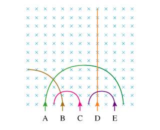

1. Five equal-mass particles (A–E) enter a region of uniform magnetic field directed into the page. They follow the trajectories illustrated in the figure.
Rank from largest to smallest velocity
2. qvBsin(theta) = ma
qvB = ma = m(v^2/r)
v = qBr/m
3. Based on their radii, it should be A > B > C=E
But what about D? It is neutral, so has no radius because it doesn't go in a circle, but clearly has a velocity despite r = 0. Is the answer indeterminate, then?
I think you're meant to assume that all particles have the same charge; otherwise, the problem would be unsolvable. So assuming they have the same charge, D appears to go straight because it's barely affected by the magnetic field. What does that tell you about its velocity?
The answer actually was that it couldn't be determined.
Now I am asked to rank the speeds largest to smallest of A, B, C, and E. I thought it was clearly A > B > C=E, but it is not and it tells me this:
The radius of the trajectory of a particle depends on more than just its speed. Be sure not to make assumptions about the relative magnitudes of the charges.
WTF?
Linus Pauling said:
v = qBr/m
The velocity depends on the charge, and you are not given any information about the charges. Therefore the problem is not solvable.
