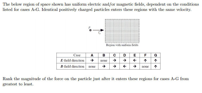

The below region of space shown has uniform electric and/or magnetic fields, dependent on the conditions listed for cases A-G. Identical positively charged particles enters these regions with the same velocity.
Rank the magnitude of the force on the particle just after it enters these regions for cases A-G from greatest to least.

A) Since the particle is positive(+) I said there would be a force F namely ( ---> ) on the particle.
B) When only B is present there is no force on the particle, Fb = qvBsin(0) = 0. This is because both B and V are parallel.
C) Same as A: ( ---> )
D) Same as A: ( ---> )
E) Here the direction of the force changes but its magnitude remains the same so: ( <--- )
F) There is an upwards force in this case. However, its magnitude is the same as was in A.
G) I have this as being two forces on the particle so G is the largest.
Overall I ranked them as follows: G>A=C=D=E=F>B
Not sure if I did these correctly any help would be appreciated.

Sounds ok to me.
Dick said:
Sounds ok to me.
Wait... you mean I got it right.. like on my own ._. I think I will go have a drink!
Sure, have a drink. I can't see anything wrong with your logic.
