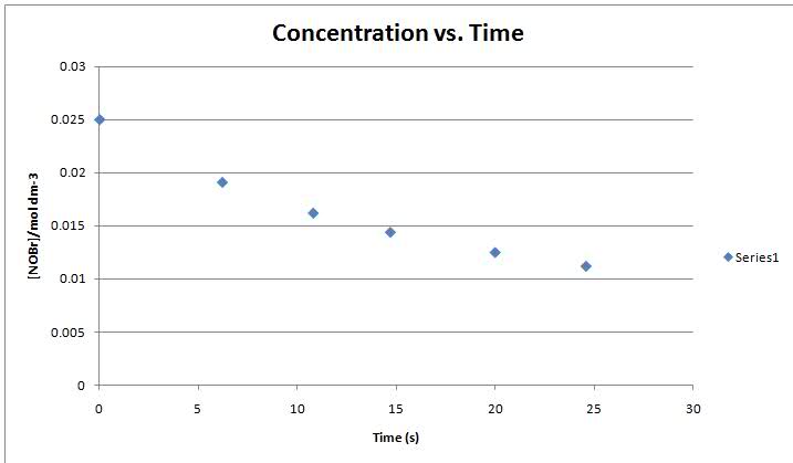

Consider the following reaction
NOBr (g) → NO (g) + ½ Br2 (g)
The table below gives the time-dependent concentration of NOBr. Using this data,
determine, if the reaction is first- or second-order, with respect to NOBr. Give the rate
equation and determine the rate constant. To do this you’ll need to generate two plots,
and be sure to explain your reasoning. Then determine the half-live and lifetime for
NOBr. Watch your units! (7 marks)
t/s [NOBr]/mol dm-3
0.0 0.0250
6.2 0.0191
10.8 0.0162
14.7 0.0144
20.0 0.0125
24.6 0.011
t1/2 = ln2/kr
So I've been trying to work through this question for about an hour and a half and can't for the life of me figure out how to even start it off. I know I need to determine the order of the reaction first but can't even figure that out. If someone could give me two or three steps to get me going that would be great.
(I've made a graph of the time vs. concentration)

My graph I made is now attached.
By the way I legitimately was trying this question as I stated before. I'm not very good at this stuff and was looking for some assistance. This perfectly standard question does not come easily for me and it difficult for me to understand.
The graph didnt attach trying again.
Says invalid file when I try to upload. Not sure how to attach the file =/

Here is my graph? Can you please help me out? I want to figure out how to do this.

On your fig. you've got [NOBr] and you've got time. How are you going to get this rate of change at any point from the fig? What are its units?
And by the way you can already quickly get a fair estimate of a half-life looking at that fig. About what would you say?
So based on the graph the half life would be approximately 20 seconds.
Umm for the rate of change of the concentration would you take the slope of the tangent line at a spot on the graph? Or is there a way to get the change of concentration for the whole thing not just an instantaneous point.

OK around 20 sec according to your fig. By the way I am wondering how the measurements in this experiment were done. How reaction was started. (Stuff was probably started somehow a time before the t=0 point.) Also why it wasn't measured for longer. Or wasn't there an experiment, were you just given numbers?
Yes I would take the rate at say half a dozen different times by slopes, after drawing a curve freehand. Then you'd get values for rates at different concentrations. You can plot those against what? , well concentration, and then try concentration squared so you can see whether it looks to be fitting one or the other of those two equations you gave, or at least one better than the other. And if it does fit either approximately or well you can obtain a rate constant according to equations you already gave.
