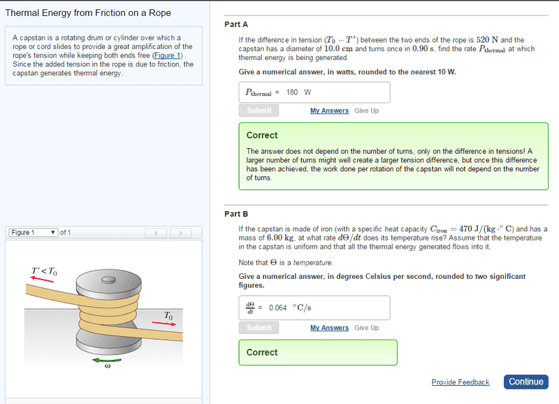

My question is regarding Part B of this problem, I have solved it but I'm wondering if there is another way to solve it since it says dtheta/dt and one of the hints I found online suggested that I use the chain rule.
Q = mc(deltaT)
Q/t = P
For the first part, i just did theta/time to find angular velocity, then multiplied by radius to find the tangential velocity, then just multiplied by the force of 520N by pi/9, the tangential velocity to get 180 Watts.
For the second part I just divided the equation for Q by t to make deltaT/t=P/mc and got 0.064 C/s.
If there was a calculus way to solve this I'd appreciate some help. Thanks

There's no calculus of any interest here, the rate is constant. Your method is as good as any.
makes sense. thanks haruspex
