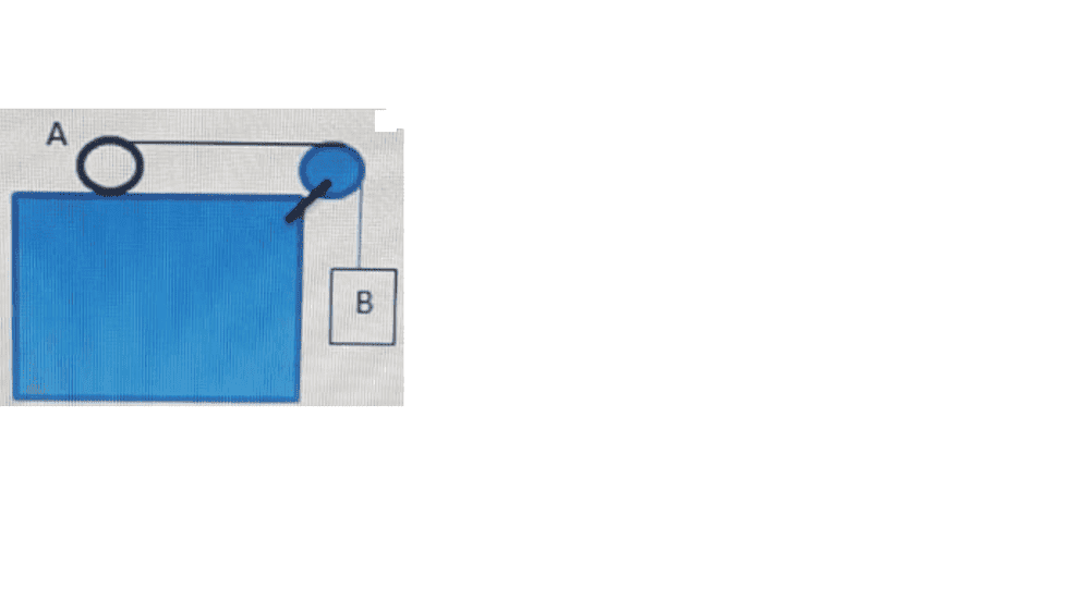

But the teacher said the friction should be directed downwards of the incline plane (not upwards)
Same as this question:
He said the friction acting on A (between the ball and table) is directed to right while I think the friction should be to the left because it opposes the motion of the ball
No, definitely upwards. It reduces the linear acceleration and increases the rotational acceleration. Without friction, it would slide down with acceleration ##g\sin(\theta)## instead of ##\frac 23g\sin(\theta)##.
In general, this case is more subtle.
Consider a round object radius R, mass m, MoI I, being pulled to the right by a force F applied at height r above its centre. Friction at tabletop is f, positive to the right.
We have ##F+f=ma=mR\alpha##, ##Fr-fR= I\alpha##.
Solving for f gives ##f=F\frac{mrR-I}{mR^2+I}##.
[corrected from original post.]
So the direction of f depends whether ##r>\frac I{mR}##. For a solid cylinder, f is to the right if ##r>\frac 12R##, and no frictional force arises if r=½R.
But in your diagram r=R, so your teacher is quite correct, the frictional force is to the right. Only for a cylindrical shell is the critical height right at the top.
Is there any possible case when a solid cylinder rolls down from inclined plane the friction is downwards the incline plane?

songoku said:
I got different result:
You are right, I made a mistake in the algebra.
songoku said:
So if the string is connected to height 1/2 R above the center of a solid cylinder and the solid cylinder rolls without slipping, then no static friction force acting on the cylinder even though the surface is rough?
Right. If the surface were frictionless it wouid still roll without slipping.
songoku said:
How to get 3/7 ?
By making a silly error.
songoku said:
So the frictional force actually increases the linear acceleration and reduces rotational acceleration?
Yes. Without friction, the cylinder would slip so as to rotate faster but move more slowly horizontally.
songoku said:
For cylindrical shell, the friction the friction will not be directed to the right, always to the left?
If the applied force is at the very top then there is no friction. Anywhere below that, the frictional force is to the left.
songoku said:
when the applied force F is below the center
If you are now defining r as distance below the centre then you should just get equation (3) but with the sign of r switched. But why do that? Just use equation (3), allowing that r can be negative.
songoku said:
I got different result for (3) and (4)
(4) is wrong. You should have got ##-F\frac{mRr+I}{mR^2+I}##, so f is always to the left.

songoku said:
But how can we know the relation between F and W sin θ?
F, W and theta are independent inputs, so you cannot in general know unless given their values.
So depending on the input, the friction can either directed upwards or downwards?
songoku said:
For this question, the acceleration of A is not the same as B? Acceleration of B will be twice of A?
Thanks
songoku said:
So depending on the input, the friction can either directed upwards or downwards?For this question, the acceleration of A is not the same as B? Acceleration of B will be twice of A?
Thanks
Yes to both.
haruspex said:
Yes to both.
So for question the object is on inclined plane, what is the best approach to use? Just assume the direction of the friction then calculate the tension and /or acceleration? If the tension and/or acceleration is negative, reverse the direction of friction and redo the working?
Yes, except that there is no need to redo any working. You are not really assuming the friction is in a particular direction; you are only defining a particular direction as positive for the frictional force. If you get an answer like -3N then you know it is 3N in the other direction.
The direction of friction force won't affect the value of acceleration or tension? I mean maybe wrong direction of friction force will result in negative value of acceleration or tension.
songoku said:
For this question, if the pulley is frictionless (so no rotation on the pulley), will the acceleration of A and B be the same? or the acceleration of B will still be twice of A?
Thanks
The key fact is that the equation is still correct, regardless of whether the value is positive or negative. A force 1N to the right is the same as a force of -1N to the left.
First, usually when one refers to a frictionless pulley one means that the axle is frictionless. It is generally assumed there is no slip between pulley and rope.
So I think you mean a massless pulley (so no rotational inertia) or replace the pulley with a frictionless ridge.
The relationship between the two accelerations is nothing to do with that. You could just consider a cylinder on a horizontal surface and someone walking away, pulling on a thread wrapped over the top of the cylinder. The distance the person walks will be twice the distance the cylinder rolls, so twice the speed and twice the acceleration.
Thank you very much haruspex
