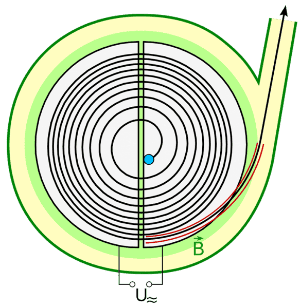

how can i keep the protons in the cyclotron? The cyclotron has one path that once completed, the proton gets out, am i right? Is not a loop

Big accelerators like the LHC need time (about an hour), but smaller accelerators are much faster. The Proton Synchrotron, which is still a large machine with 600 meters circumference, has a cycle time of just a second. The linear accelerators before that are even faster: The protons move through them at thousands of kilometers per second, and the accelerators are just something like 100 meters long: The acceleration has to be fast - less than a millisecond. If you start up the whole machine, it might need some time for calibration and whatever, but that is equivalent to the safety hatch, not the trigger.
It becomes a loop if you switch off the accelerating electric field.
