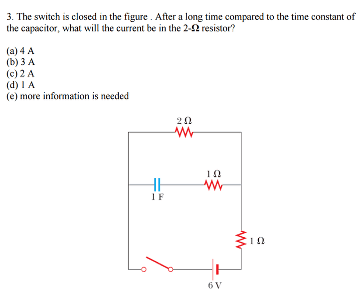

RC Circuit Current Help: Equations and Attempt at Solution
In an RC circuit, the current through the capacitor approaches zero after a long period, allowing for the simplification of the circuit by removing the capacitor. The equation q = Q(1-e^{-t/RC}) describes the charge on the capacitor over time. Understanding this behavior is crucial for analyzing circuit dynamics. The discussion emphasizes the importance of recognizing steady-state conditions in circuit analysis. Overall, mastering these concepts is essential for solving RC circuit problems effectively.
minimario
95
##q = Q(1-e^{\frac{-t}{RC}})##
Don't know where to start...
What can you say about the current in the branch containing the capacitor after a long period of time?
Goes to 0?
yes. So you are allowed to cut that part out of the circuit since doing so does not affect the rest of the circuit.
Ok, got it.
