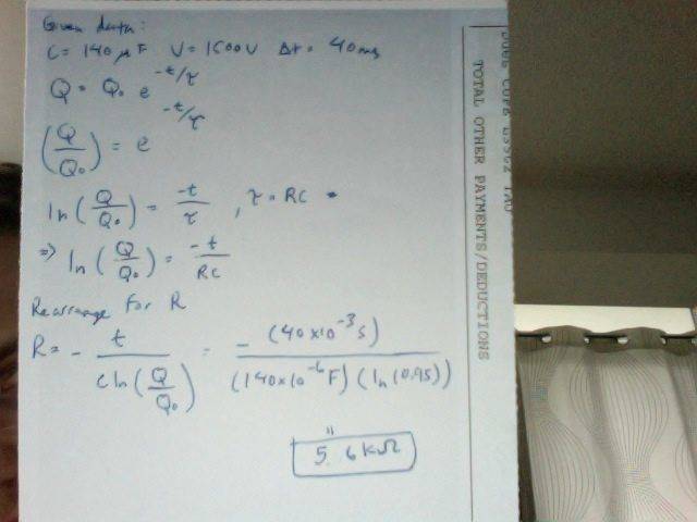

A 140μF defibrillator capacitor is charged to 1500 V. When fired through a patient's chest, it loses 95% of its charge in 40 ms. What is the resistance of the patient's chest?
According to "Mastering Physics," the solution that I have provided is incorrect. I don't know what I've done wrong.
Given: C=140μF V=1500 V
-loses 95% of its charge in 40 ms
Needed: R=?
Q=Qoe-t/τ
(Q/Qo)=e-t/τ
ln(Q/Qo)= -t/τ
τ=RC
ln(Q/Qo)=-t/RC
Rearrange for R
R=-t/(C(ln(Q/Qo))
=-(40x10-3s)/((140 x10-6F)(ln(0.95)))
=5.6kΩ
  • Handwritten derivation of RC discharge resistance: Q = Qo e^(-t/RC), ln(Q/Qo) = -t/RC, R = -t / (C ln(Q/Qo)) = -(40 x 10^-3 s) / ((140 x 10^-6 F)(ln 0.95)), boxed result 5.6 kΩ.

The solution looks correct, try to use more significant digits.

Sorry that I can't help you, but this is for any future students coming here for a similar problem. The OP did almost everything right. His only problem was that since the capacitor loses 95% of its charge, the final equation should include ln(0.05) for the 5% of the charge remaining, not ln(0.95). Hope this helps!
