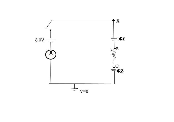

C1= 2.0 μF
C2= 5.0 μF
the resistor has a resistance of 0.10 MΩ
The circuit shows the charging of a capacitor
a) At t=0 the switch is closed. What is the initial measuring on the ammeter?
b) After the current has decayed to zero what are the voltages at points A,B and C?
Q= Qo e^(-t/cr)
Well at t= 0 the current should be 0
and then for the b) the current should decay to zero at t= ∞ , right? But if I use this idea I can't calculate any voltages and I just get confused.At first I thought since the current decayed to zero... the capacitor were fully charged so . I found the effective capacitance
Ce= 1.43μF
Q=CV
Q= 1.43x10^-6 x 3 = 4.29x10^-6C
Then I used that to find the voltage at each point.
But my teacher didn't agree...
Help is much appreciated!

(a) - they mean the initial reading after the switch is closed.
(b) - after a long time, the capacitors will be charged up due to charge having been shifted between the plates.
The voltages at the different points will depend on the charges. Well done.
But you can use your knowledge of circuits to figure the voltages.
i.e. the voltage on the top plate of C1 is 3.0V ... do you see how I did that?
similarly, the voltage on the bottom plate of the bottom capacitor is 0.0V.
now you just need the voltages on the other plates ... are these going to be the same or different?
i.e. is there a voltage drop across the resistor?
If the capacitor is fully charged shouldn't it's p.d. equal the voltage of the supply so everything else should be zero?
I didn't know the voltage of one plate could be different from the bottom plate, thought they would be the same.
If the voltages on each plate are the same, then what is the potential difference between them?
The PD across a capacitor is the same as the supply voltage if it is the only components in the circuit.
If the voltage is the same on each plate the p.d. would be zero. So the P.d. at A is referring to the top of the plate of C1 so that is 3V? The voltage of the resistor would be... V= IR but... the current is zero so the voltage is also zero? and C is referring to the voltage of the top plate on C2 so it would be... I'm not sure... if the current decayed to zero , that means one of the capacitors became fully charged.. so the C2 has a p.d. of V.., but I don't know the charge or the current so I can't calculate it's p.d.
So you can treat the circuit as if the resistor is not there.
What the voltage source has done is move charge Q from the bottom plate of C2 and put it on the top plate of C1.
If the voltage on the bottom plate of C2 is zero (using the [-] terminal of the power supply as a reference) then the voltage on the top plate of C1 is +3V.
If the charge on the top plate of C1 is +Q, what is the charge on the bottom plate (of C1)?
Do you know an equation that relates the voltage across a capacitor with the charge on each plate?
Do you know an equation that relates the voltage across each capacitor with the total voltage across both?

Ah I see... so C2 discharged and electrons went to the top of C1 , so the Voltage at A is 3V,
B is 0V
C is also 0v since it discharged right?

Yeah I know equations Q=CV . If the top plate has +Q the bottom plate has -Q. So you're saying I should find the effective capacitance and then find the charge? If I ignore the resistance and have one effective capacitor... then it will have the full voltage of 3, by Q=CV i could find the charge, since they are in series they should have the same charge but different voltages.. so I should just work out the voltages on each capacitor?
No.
If a capacitor is "charged" that means that +Q is on one plate and -Q on the other plate.
If the charge on the top of C1 is +Q, what is the charge on the bottom of C2? From that - what is the charge on the top of C2? ... i.e. both capacitors will have charge +Q on their top plate and -Q on their bottom plate.
Well done :)
Write down the expression relating the voltage across each capacitor - individually - with the charge on it.
You don't need to work out the charge - just leave it as Q. This should give you two equations and three unknowns.
The next step is to relate the voltages across each capacitor to the total voltage across both of them.
This is the final equation: with three equations and three unknowns, you can solve for V1 and V2.
The only equations I have are V1= Q/C1
V2= Q/C2
V= Q/C1 + Q/C2
I'd have written V=V1+V2 ... you substituted too soon.
But it doesn't matter:
You know V, C1, C2.
You don;t know V1, V2, and Q.
... that's three equations and three unknowns.
Do you know how to solve simultaneous equations?
V1= Q/(2x10^-6)
3= V1 + V2
V1= 3-V2
3-V2 = Q/(2x10^-6) ( But V2= Q/5x10^-6)
3 - Q/(2x10^-6) = Q/(5x10^-6)
3= 700,000Q
Q= 4.3x10^-6 C.
V1= 4.3x10^-6/2x10^-6 = 2.15V
V2= 4.3x10^-6/5x10^-6 = .86V.
Why did you bother to compute Q??
You can eliminate it right of the bat in step 1 - use your first two equations to get:
1. C1V1=C2V2 so that V2=C1V1/C2 ...sub that into:
2. V=V1+V2 = V1+C1V1/C2 and solve for V1...
it is best practice to do the algebra before substiting the values.
You need to control that urge to leap ahead - it's getting you into trouble.
Still - good effort.
